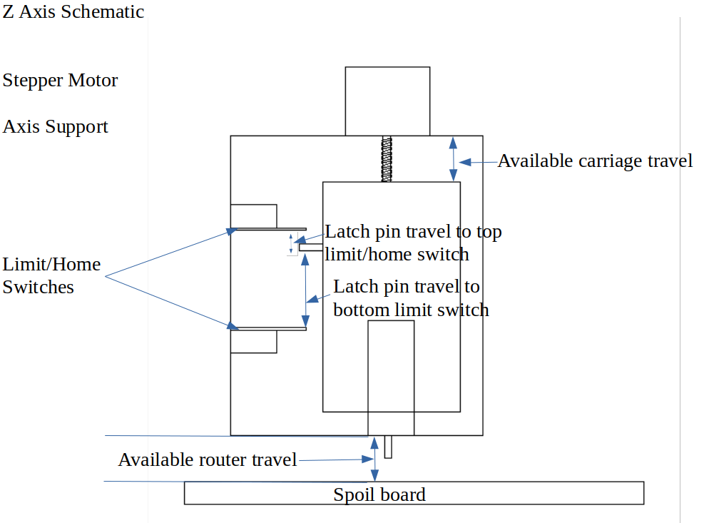

Finally, the attached schematic, illustrates the relationship between available physical travel limits and available travel between limit switches for the Z Axis.
This is not to scale but, as illustrated, while the available travel between the latch pin on the router carriage and the upper home switch is less than the total available upward travel for the carriage, during homing (and given the inversion of the step direction pin I wrongly initiated) the pin activates and latches at the upper switch but then the carriage continues upwards until it reaches the upper physical limit.
Hopefully taking Andy's advice will rectify this.
Conversely with the bottom limit switch it will be seen that the chuck on the router will reach the physical limit (the spoil board) before the latching pin engages the limit switch. This will have to be rectified by moving the limit switch upwards.

- Posts: 19899
07 Nov 2019 12:50 #149847
I suspect that there isn't a physical fix for this, as a machine needs to be able to reach the table with a short tool, so can always machine its own table with a long tool.
I don't even think that the soft-limits help, those only consider the joint limits. It would be nice to have tool-point limits, possibly even a way to define complex volumes to avoid chucks and fixtures.
Though you can bet that such would be 10x as annoying as the already-annoying soft limits warnings.
Replied by andypugh on topic Settings for Homing

07 Nov 2019 19:43 #149870
by ytiuqibu
Replied by ytiuqibu on topic Settings for Homing
Thanks Andy,
I am inclined to agree with you and, in our situation, makes the bottom limit switch on the Z axis superfluous. As long as we can have the homing moves associated with the upper switch travelling in the right direction we can ignore the bottom switch and work on utilising the touch off tool/plate/probe (attached to pin 15 designated probe input) to zero the Z axis for actually running jobs.
