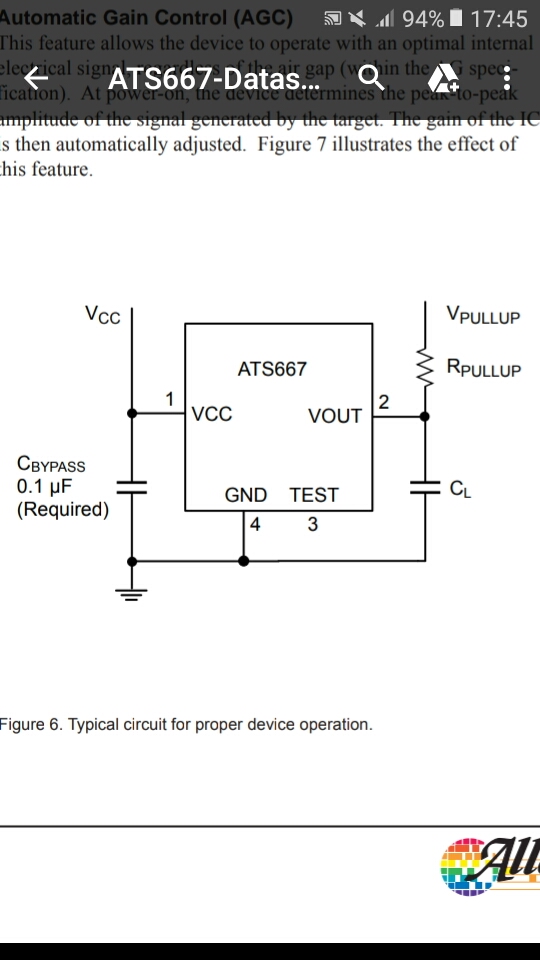

- Dinuka_Shehan
- Posts: 333
- Thank you received: 26
09 Nov 2019 13:56 #149982
by Dinuka_Shehan
Replied by Dinuka_Shehan on topic Rotary encoder with gear tooth sensor
- Todd Zuercher
- Posts: 4782
- Thank you received: 1472
09 Nov 2019 14:05 #149983
Replied by Todd Zuercher on topic Rotary encoder with gear tooth sensor
Just remember reading these (or any encoder) will be limited to speeds with pulse widths wider than your base-thread.
