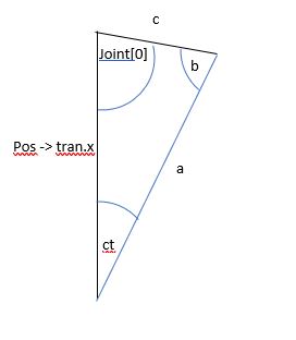

Hello, I am a beginner user of Linuxcnc and am trying to get a simple mechanism controlled. It is like a two arm delta robot but has only one motor to control both arms through a couple of gears. I have modified the trivkins file with trig that represents a simplified version of the mechanism but now I am lost. The fwd and inverse kins return the same values when i check them manually but when i start linuxcnc - home the axis - swithch to MDI the joint [0] i have modified runs away with no input. I have linuxcnc 2.5.5 running on Ubuntu. Maybe I need need to make some modifications to the HAL? I looked at the delta robot kins and see there are modifications to include the lengths of the arms, do i need to include this or can it all be achieved with modifications to the kinematics file?
I have tried to include my kins file and an image to explain how i got to it (hopefully it works). The image shows just half of the mechanism, the other half being the mirror. Hopefully it makes sense (or maybe not)... Also a picture of an industrial 2 arm delta robot.
I have read a lot and feel like im getting close but its getting frustrating!
Any and all help would be greatly appreciated and my apologies if this is the wrong way to do things - im new at this.

It doesn't seem likely that changing joint-0 only changes X and not Y?
So I don't think that your kinematics is correct.

Thanks Andy, the link can only move in one axis. I probably should have used Z. The closest analogy i can think of would be replacing the Z axis on a standard cartesian mill with this delta 2 style mechanism - so it is only moving up and down. Does your comment from above still apply? If so i really don't have a clue about what is going on...

OK, I think I see how it works now.

I see you also here mix degrees and radians.
The output from trig functions is radians and that is also what they need as inputs.
A "180" is clearly wrong here, should be M_PI.
Also check how the values for the joints come over as - degrees? Radians?
May need to convert back and forth to radians. Or degrees if that's what the joint value is.

radians / degrees might be all that is needed to explain the runaway.
Also the calculation should be able to use the equation here:
www.mathsisfun.com/algebra/trig-solving-sas-triangles.html
ie, I don't think you should need to calculate the "ct" term.
But you do need to either scale and home joint[0] in radians, or convert to radians. But in either case that joint angle should be usable without modification if it has the right home position defined.

Thanks for the help everyone. Radians was one error and i had forgotten to subtract the length of the arm at the home position from the fwd kins.
