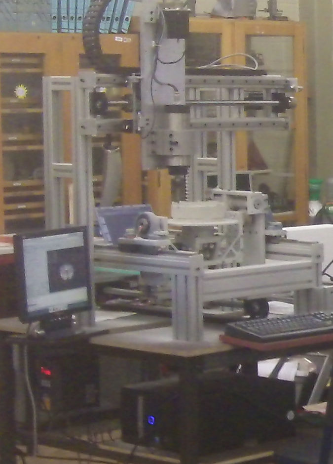

Hi
im on a 5Axis TCP the Trivial Workes fine XYZAC
so im Adviced to see the VISMACH example
github.com/LinuxCNC/linuxcnc/blob/master...ilting/xyzac-trt.ini
here the numbering is straight BUT there is B inside the XYZAC Mashine as joint_4 // C is joint_5
and Vismach gets C as joint_4
HALCMD = net :rotate-c joint.4.pos-fb xyzac-trt-gui.rotate-c
This is taking my head of the System
as the Simulation Work fine on AC
PLEASE give me a Answer on this setup
REAL Machine is there a advice on Homing Sequence First Liniar last Rotary
as i learned the machine needs to homed to almost the Rotatet Zero and nearest save Liniar to work prober
otherwise the Jog axis fails as the Rotarys are not at Zero AC as
after Homing all axis move TCP on a Tilded rotary A or C

Which version of LinuxCNC are you using? 2.8 onwards works a lot better for non-trivial kinematics.
But in that case the joint numbers are controlled by the kinematics. You could make a kins where joint 9 was the X axis, if you wanted to.
So, the HAL needs to match the kins, and the INI needs to match both.

there is a switch kinetics for selfcompiling for a AC 5Axis
how do i compile the C file
can i use DEV halcompile or do i need a gcc
im on Debian 9 and 2.9 from buildbot

Try halcompile, it will either work or not.
