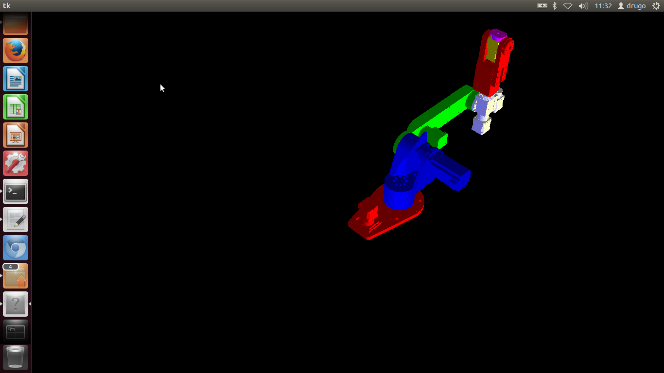

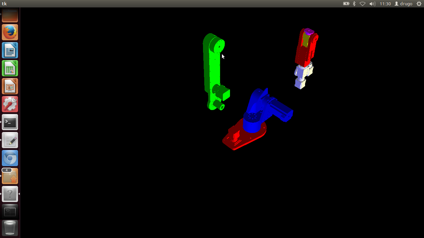

Hello,
I am currently trying to work on a AR2 robot simulation on Vismach. I am importing all the parts from STL assembled in a group I have 7 groups STL files. I am really struggling to understand where is the origin of the Vismach coordinate system and where are the origins of the groups compared to the Vismach origin. In fact when I try to rotate a link I get both a translation and a rotation and I cannot recover the translation since I have not understood where it is located the link compared to the origin of Vismach.
Could anybody help me please with this?
I attach two screenshots to show the behavior, the py Vismach file and the STL files I am using. The STL files should be located in a folder called AR2ForVismach to let work the py file work. The py files should be just in the directory upper to this directory.
Thanks a lot in advance.
Ugo

you need to setup the vismach file the same way you setup your controll
as of robot the 0,0,0 is most the center of the BASE
but you can make it a outside Workarea also and define the ranges you like
see the examples of the SCARA and PUMA
they are lockated under SIM/AXIS/VISMACH in your running Linuxcnc StartGui

To get it to work was quite a task. I basically took a working example of a robot arm, changed the stl files and worked through the code. This way I fumbled my way along. The original code I used started from the tool tip backwards to the base which seem counter intuitive but it worked.
The workflow is to create or import the first part then orient (rotate) it correctly in space then move it so that the point of rotation/connection to the next part lies in the vismach origin (this can be displayed by creating a separate visual coordinate system (mine is called "world coordinate system" and ends up being at the center of the bottom of the base.) Then you define the connection with LinuxCNC Joint using HalRotate. Then the next part is inserted -> rotated ->translated to join the rest of the arm -> connect the arm together with "Collection" -> translate to origin of the next connection -> define HalRotate for this joint -> add next part.
The reason I created different poses is the problem to create the fitting modified Denavit-Hartenberg values that then matches the genserkin kinematics to the vismach model. Thats why I ended up with the configuration in melfagui that is actually not a "natural" pose for the arm. But I have not been able to change the DH-values so that the start position is a more natural pose. Mostly because genserkins does not allow us to define theta values.

I struggled a bit with this when I created the VMC-toochange model. I wrote the current Vismach docs at the same time (previously there was even less documentation).
I found that it helped to set up the CAD model with everything in the right place before importing it.
Then the origin of each part is at the CAD origin, so the first thing you need to do is move that to the centre of the part joint before making the links.(Or, at least, that is what I seem to recall doing)
(I can't check the docs right now, it looks like www.linuxcnc.org is down....)
