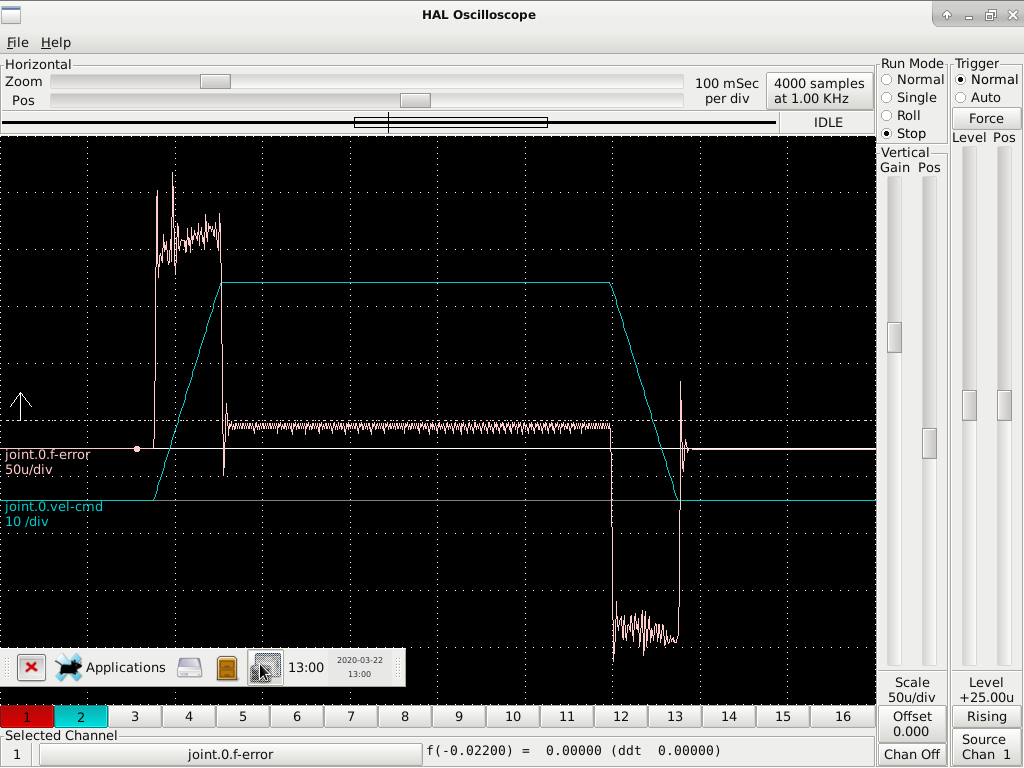

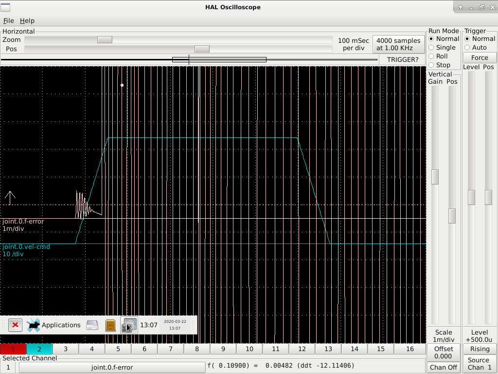

Now we have sorted the plasma arc problem I am moving to the next problem re f-error s
These first two seem to run OK.
These next two through an f-error

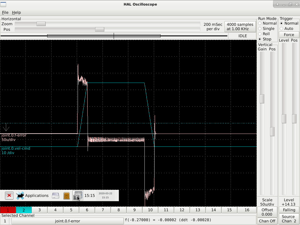

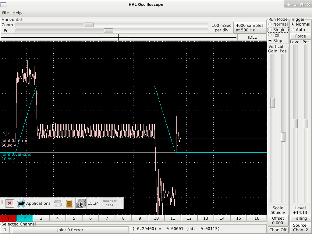

This plot is where I could hear the stepper jitter
What would cause this

The stepgen maxaccel and maxvel need to be at least 25% higher than the
joint limits = 2250,150 respectively
BTW your plots are not showing up, can you attach them rather than use links?

22 Mar 2020 19:44 #161135 by PCW
Replied by PCW on topic F-Error problems
On all plots you could use some FF2
Probably 0.00012 to .00025
What kind of machine is this that you need (and than can handle) >2G accel and 3600 IPM?
Last plot show loss of DPLL lock, This can be due to host base time issues
what host hardware do you have? does it have internet connections?

Peter sorry about the links I don't know what went wrong. I think they are correct now.
I am have trouble in that the same code will run ok but a second time I hear a different noise from the steppers like missing steps.
I do have a wifi dongle in the pc could this be a problem?
re. What kind of machine is this that you need (and than can handle) >2G accel and 3600 IPM?
So I thought that would be 3600 mtr/min
My machine is metric so is this valid for metric F2 0.00012 to .00025

22 Mar 2020 23:30 - 23 Mar 2020 00:26 #161153 by PCW
OK that has a Intel MAC, do you have IRQ coalescing disabled? (as mentioned in the hm2_eth man page)
A good check on this is pinging the Ethernet FPGA card and checking the ping times
