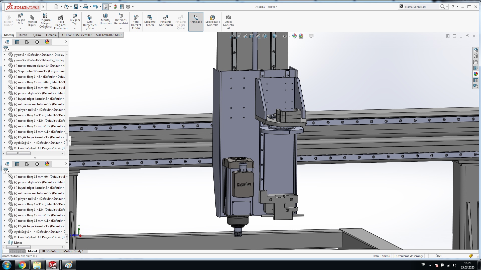

Hello friends, I just joined the forum now.I designed a cnc router and chassis production is finished. I am currently installing the electronics. Router dimensions y 2800mm x1450 mm z450mm
Standard 3 axis cnc router In addition I have the 4th axis that can rotate 360 ??degrees.this axis will turn 90-180-270-360 degrees.consider a wood panel spindle holes in the surface and side hole in 4.axis .My axis motors nema 34 12nm stepper.I haven't bought a cnc control board or control panel yet.this is my first cnc router and my knowledge is very little.
I have no knowledge of software.i use autocad 3d max solidwoks very well but i don't have cam knowledge.
If you help me in this matter, you will make me very happy
Thanks in advance to everyone for help

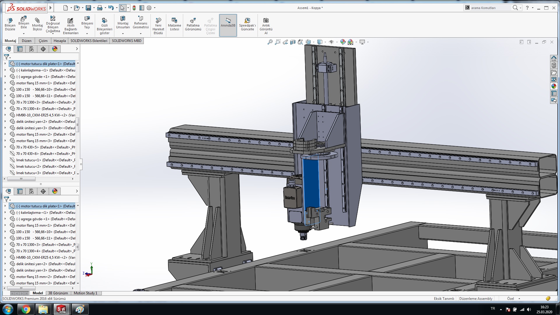

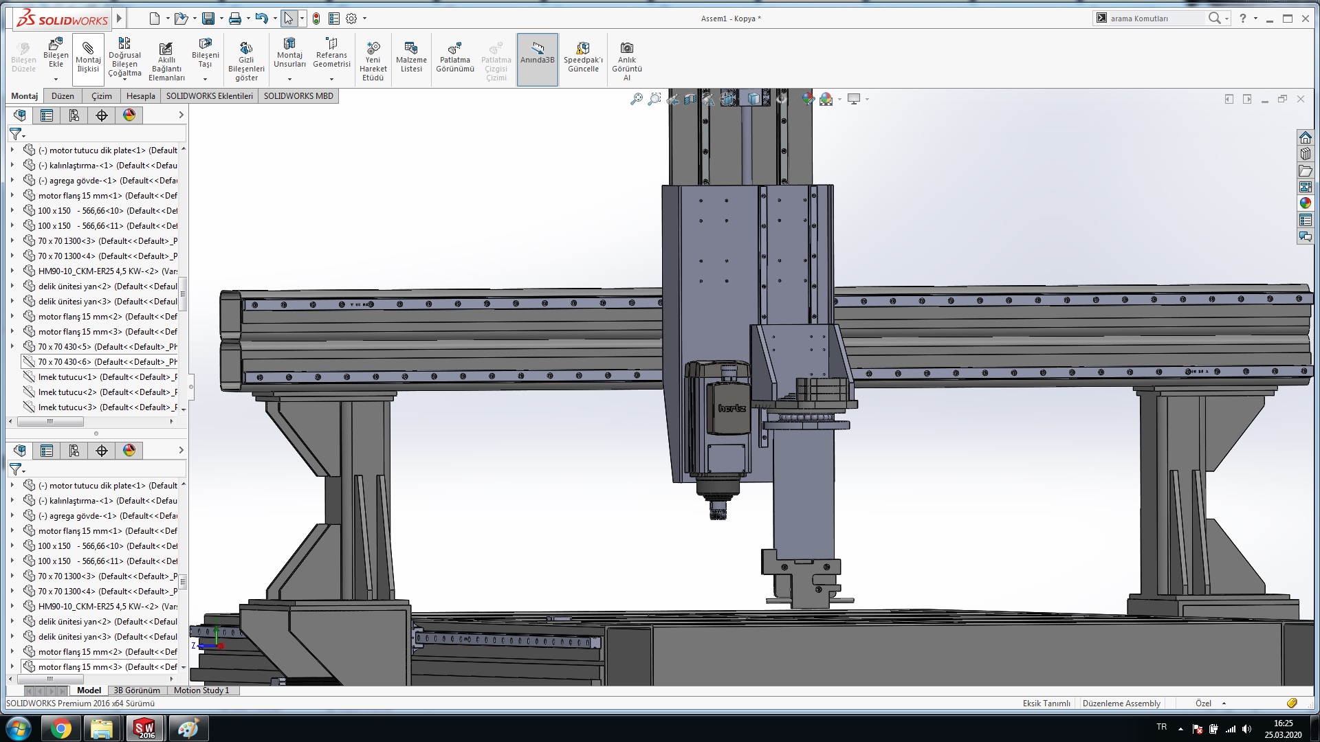

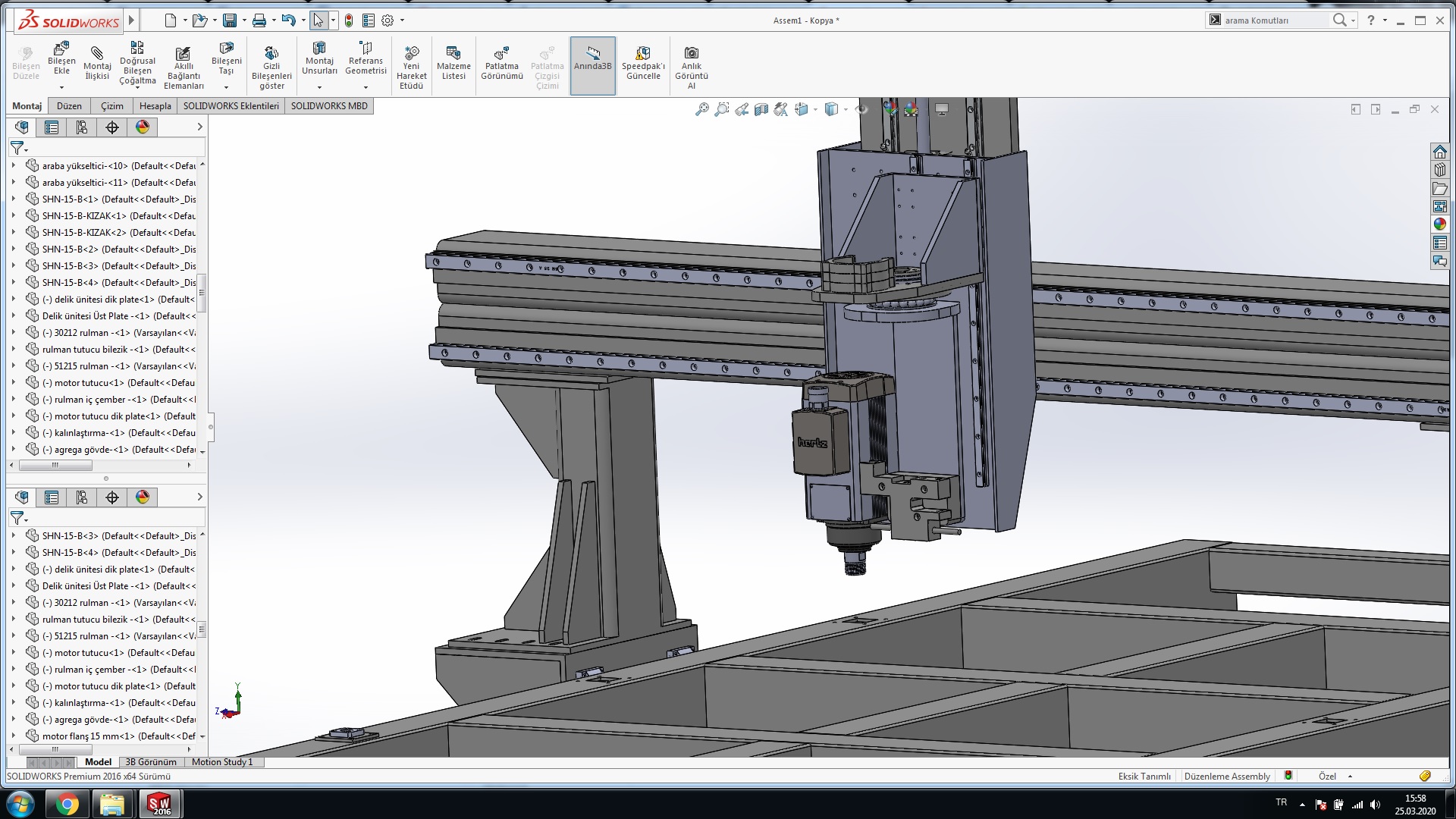

Did you look at the pictures in my first message?
my machine is not a standard machine

Replied by cmorley on topic I Need help for 4 axis cnc
Ahh yes - the second head is a little non standard
What does it do?
What does it do?
