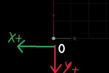

06 Apr 2020 13:19 - 06 Apr 2020 13:19 #162909
by alexandrub
how to invert axes ? was created by alexandrub
Last edit: 06 Apr 2020 13:19 by alexandrub.

- alexandrub
- Posts: 61
- Thank you received: 5
06 Apr 2020 14:36 #162918
by alexandrub
Replied by alexandrub on topic how to invert axes ?
My orientation is ok.i want just viewing to change.

- Posts: 7368
- Thank you received: 2181
06 Apr 2020 15:04 #162922
Replied by cmorley on topic how to invert axes ?
well plasmac axis and plsmac gmoccapy are a little different change.
You will need to hand modify a python file and if you update will probably have to modify it again.
/usr/lib/python2.7/dist-packages/glnav.py
look AXIS for :
change the one line to:
save the file and one of the Z views will be as you requested.
Chris
look AXIS for :
def set_view_z2(self):
self.reset()
glRotatef(-90, 0, 0, 1)
mid, size = self.extents_info()
glTranslatef(-mid[0], -mid[1], -mid[2])
self.set_eyepoint_from_extents(size[1], size[0])
self.perspective = False
self.lat = 0
self.lon = 270
self._redraw()change the one line to:
glRotatef(-180, 0, 0, 1)save the file and one of the Z views will be as you requested.
Chris
- alexandrub
- Posts: 61
06 Apr 2020 15:49 #162926
by alexandrub
It is not glnav.py in this path...or i dont find.
