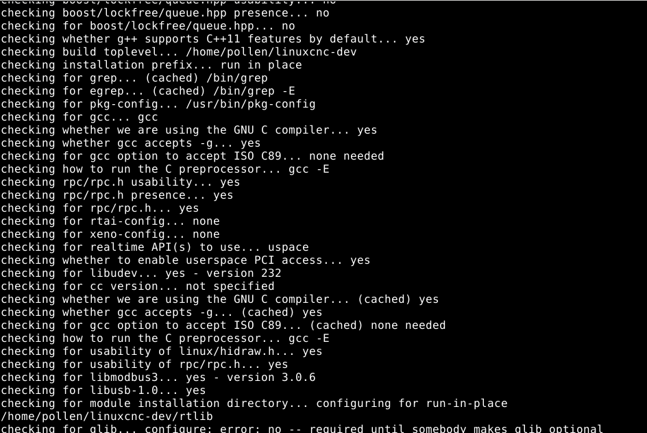

Hello, I am really new to linuxcnc, and I am struggling to make work my XHC-WHB04B-4 axis pendant on linuxcnc 2.7. Can someone guide me really step by step please?
I have tried the talla video on youtube but I have the glib error and couldn't go further.
Thank you for your help
Kevin
Kevin

Replied by andypugh on topic XHC-WHB04B-4 axis pendant configuration
I don't think that you should need to compile anything.
www.linuxcnc.org/docs/html/man/man1/xhc-hb04.1.html
Might help (a bit)
Might help (a bit)
