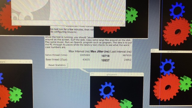

Pncconf latency was created by PMCD
- Posts: 12152
- Thank you received: 4144
19 Sep 2020 01:15 #182694
Replied by rodw on topic Pncconf latency
None of those.
Its asking you what speed you want tot run the servo thread at, not what the jitter is.
Unless you have changed the default servo thread period (1000 times per second) to suit different hardware, say a Raspberry Pi which may need a slower servo period, just make it the same as the recommended shown below it.
