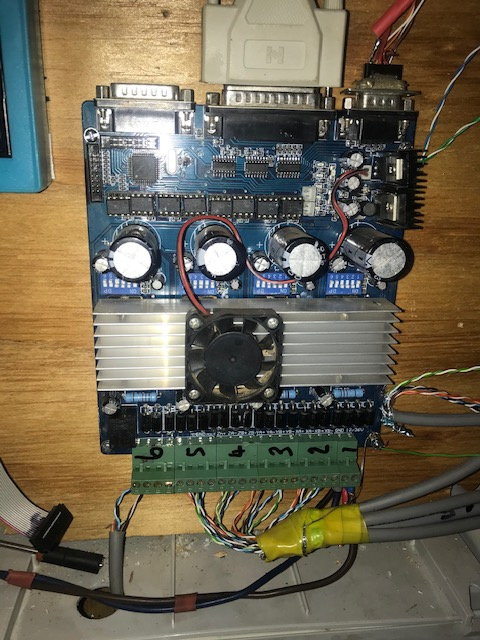

Hi, I tried to set up my XYZX gantry plasma homebuilt machine.
I finally managed to get all the parport pins sorted out and everything steps except the second X.
Please help me get this second X axis working. Ini and hal file attached.

That config is way to messed up to be usable and would have to be thoroughly edited for it to work.
Make a new config for a 3 axis machine, copy the X axis section and edit it to stepgen3 and add the relevant parts for stepgen 3 in the hal file, copy the joint0 and paste it under joint0 in the axis X section of the ini file and rename it to joint 3, add another X to the traj section in the ini file.
