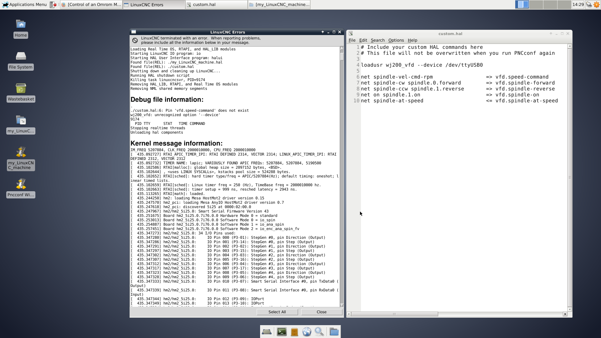

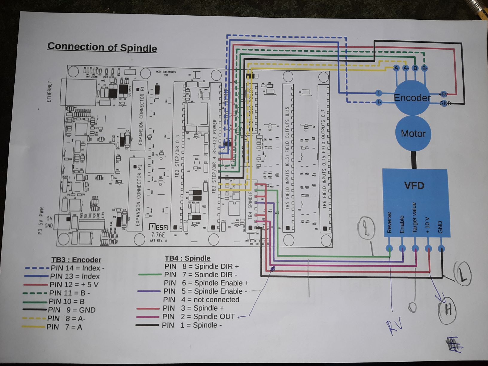

Good morning all ,
after looking for and reading the posts on the hitachi wj200 vfd, i'm lost.
I have 2 problems, the first is the connection I am attaching the diagrams of the 7i76 and the logic wj 200, I do not know where to connect the spindle out on the wj200.
the second is a loadusr wj200 error. can you help me ?
