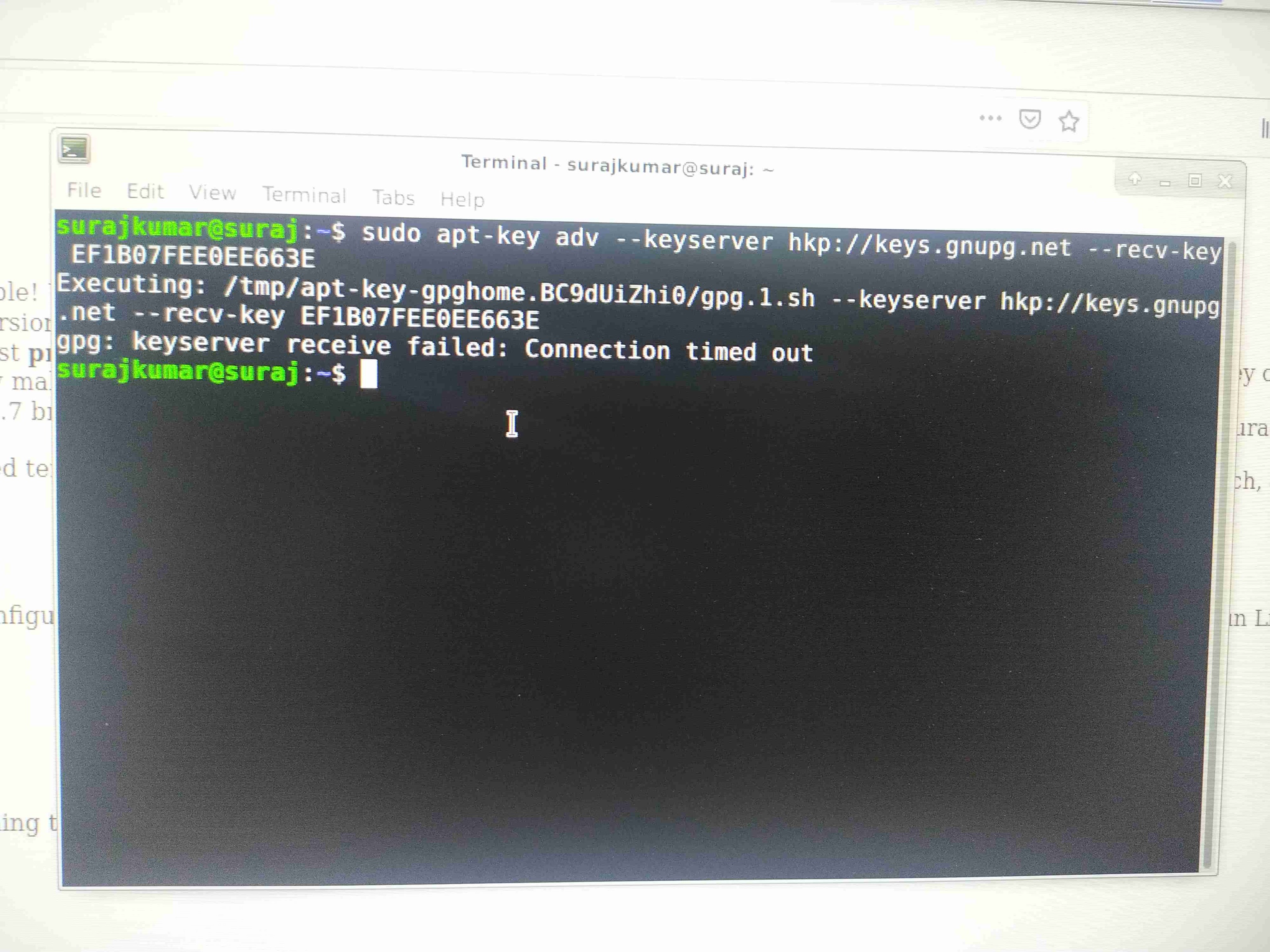

Getting error, upgrade from 2.8 to 2.8.1 Debian 10 Buster PREEMPT-RT ISO was created by suraj9735

Replied by chris@cnc on topic Getting error, upgrade from 2.8 to 2.8.1 Debian 10 Buster PREEMPT-RT ISO
This message is from keyserver. Not important. Try next steps

W: Target Packages (contrib/binary-amd64/Packages) is configured multiple times in /etc/apt/sources.list:3 and /etc/apt/sources.list:5

Seems your sources.list is corrupt. I can't give you my example.
Try to fix it and add line:
deb buildbot.linuxcnc.org/ buster master-rtpreempt
If not possible show your file. Command:
cat /etc/apt/sources.list
Here buildbot.linuxcnc.org/ is also a solution for your keyserver message.

Replied by andypugh on topic Getting error, upgrade from 2.8 to 2.8.1 Debian 10 Buster PREEMPT-RT ISO
I think that the problem is that you are trying to install from scratch on top of an existing installation.
All you really need to do is update LinuxCNC. And I am surprised that the OS isn't nagging you to do that.

That was my doing in wrong way.
I just used command line to update it. And it's done
