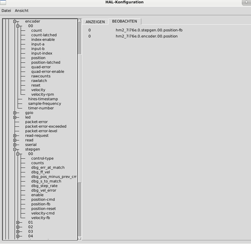

First of all, the system has to work without extra linear encoder. And yes your system is closed loop. The encoder on your servo closes the loop to the amplifier. If something goes wrong with the servo, the amplifier gives an alarm.
The second loop is your scale to linuxcnc. In the case of imprecise mechanics or, in my case, a gantry drive with a belt, useful additional security.
Therefore it is important that the scale and servo position are the same. Otherwise one always runs after the other and it also vibrates. Check that by switching off the scale.
encoder offstepgen feedback active
Then compare encoder position and step position. They have to be the same if not adjust your scale parameters. Verify the whole thing with a dial indicator.
Other things. Your servo and amplifier already have their own control loop with KP parameter. It is a good idea to tune this control loop and keep KP in linuxcnc as low as possible.
Finally turn on your scale and it will work.
The following error can be found in joint.0.f-error or using halscope.
encoder off
#net x-pos-fb <= hm2_7i95.0.encoder.00.position # Encoderpostion to PIN x-pos-fbnet x-pos-fb <= hm2_7i95.0.stepgen.00.position-fb # Stepgenposition to PIN x-pos-fbThen compare encoder position and step position. They have to be the same if not adjust your scale parameters. Verify the whole thing with a dial indicator.
