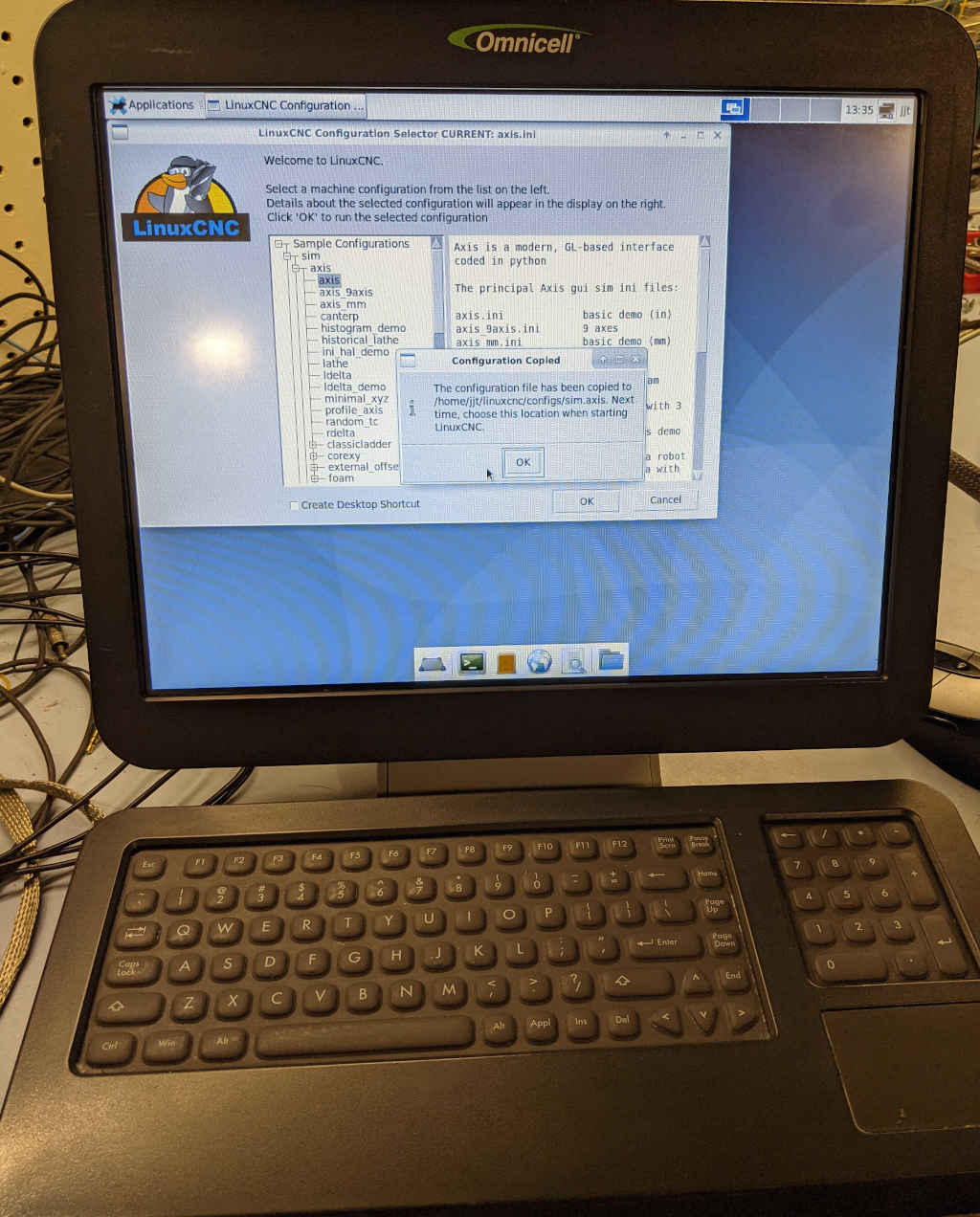

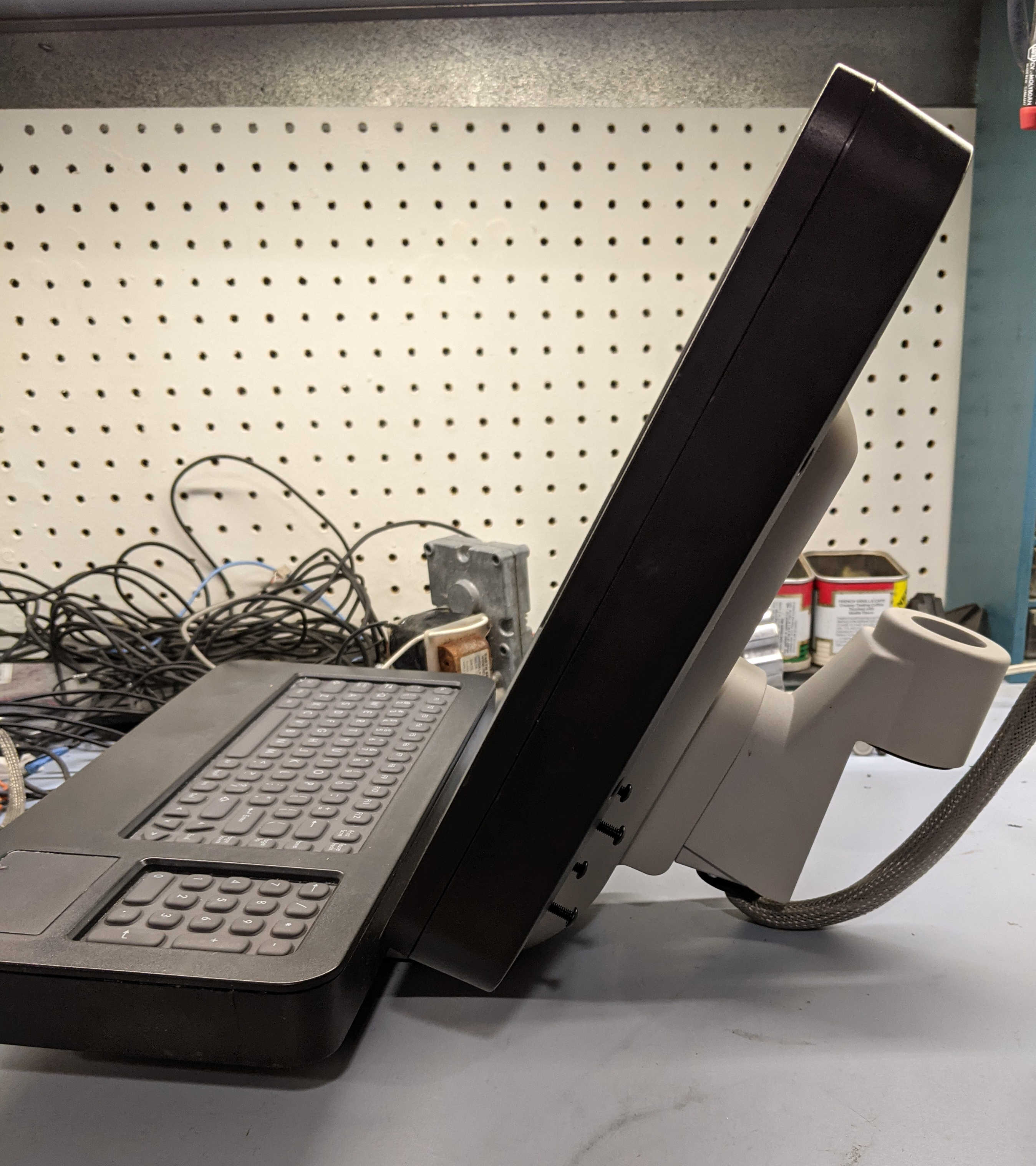

A dumpster-diving friend gave me a truckload(18) of medical computers that should make nice CNC computers. The corei3 computer isn't anything special, but the 15" touch screen LCD and rugged keyboard have a pole mount that will make for an easy machine mount.
I installed the default 2.8 .iso and added the xinput and xinput_calibrator packages for the touchscreen.
I can see my device using "xinput --list "

But when I try to use it, the touches are flipped on a diagonal. (XY swapped, XY inverted???)
After I run xinput_calibrator, I have:
jjt@debian:~$ sudo more /etc/X11/xorg.conf.d/99-calibration.conf
Section "InputClass"
Identifier "calibration"
MatchProduct "Hampshire Company TSHARC Analog Resistive"
Option "MinX" "117"
Option "MaxX" "65482"
Option "MinY" "64"
Option "MaxY" "65428"
Option "SwapXY" "0" # unless it was already set to 1
Option "InvertX" "0" # unless it was already set
Option "InvertY" "0" # unless it was already set
EndSection
But no matter what I set for SwapXY, InvertX, InvertY, my touches are flipped on the diagonal. (top right and bottom left are ok but everything else is flipped about the diagonal. I also tried saving this info to /usr/share/X11... with no success.
I figured out how to swap XY using "xinput set-float-props 12 149 0.0, 1.0, 0.0, 1.0, 0.0, 0.0, 0.0, 0.0, 1.0" but XY are still inverted.
Any insight into why my xinput-calibrator file isn't working would be appreciated.
Alternative would be help using xinput to invert x and y.

I got the touchscreen working, but what a holy mess!
Eventually, installed evdev package and was able to get it working.
Originally, linux was using libinput and I couldn't get the axes swapped using libinput. (still not sure why it didn't work)

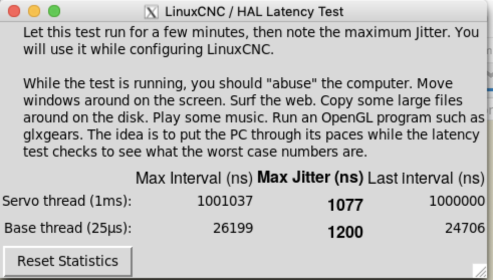

07 Mar 2021 01:43 - 07 Mar 2021 01:45 #201247
My development PC is a Core i3. It has rather good latency.
Replied by andypugh on topic TouchScreen calibration
