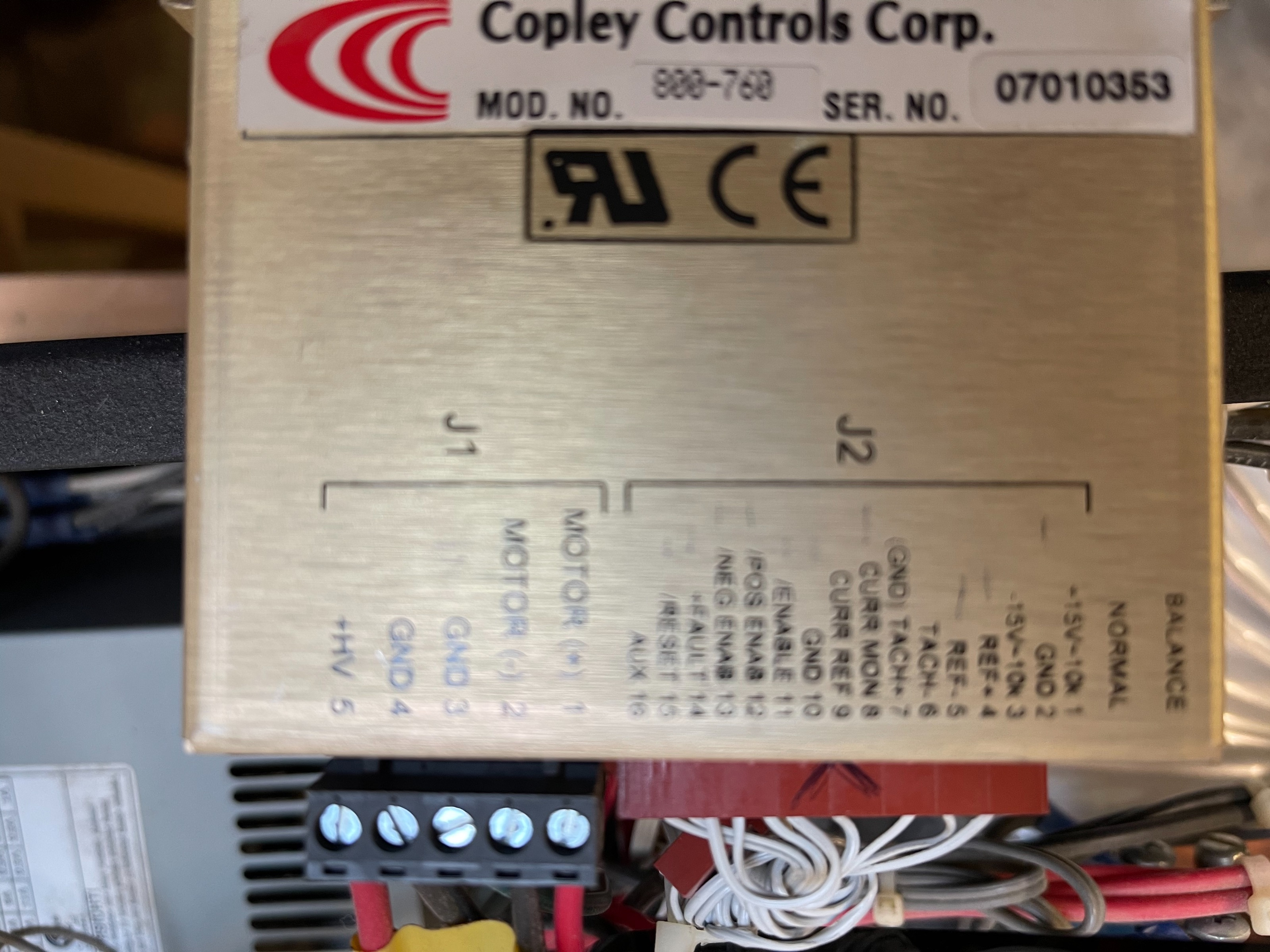

- chalky
- Posts: 3
25 Mar 2021 14:50 #203621
by chalky
Replied by chalky on topic PRECIX 4X4 CONTROLLER UDATE
No info on drives , took 1 out the other day to take some info off it and took photo at same time . I’ve attached the photo
- Thank you received: 4652
27 Mar 2021 21:40 #203840
Replied by andypugh on topic PRECIX 4X4 CONTROLLER UDATE
Looks like a DC servo drive, tacho feedback, +/-10V control.
(Going by the pin names)
Having a look around on the Copley Controls web site, I found this:
www.copleycontrols.com/wp-content/upload...00_Series-Manual.pdf
Which is for "200" series drives, but oddly these have model numbers like "800-07" so the description there might be similar to your drives.
In any case, it looks like a job for a Mesa 7i77 or a Pico PPMC.
