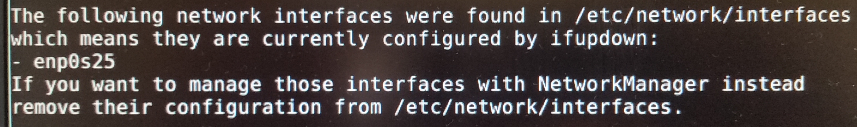

Well I'm a very happy chap today. Wiped the slate clean and booted from ISO again. Upgraded to 2.9 correctly this time un-ticking only the 2.8 related repositories in Synaptics.
Now referring to these instructions again:
forum.linuxcnc.org/27-driver-boards/3559...ethernet-mesa-boards
I noticed a sneaky little message among the trillions of lines in terminal when I ran:
so I used the Nano editor to get into /etc/network/interfaces and comment out any references to my network adapter enp0s25. Absolutely no idea if I was doing the right thing but this time when I ran Network Manager as per the above thread, all went smoothly and I could ping and connect to my 7i96.
Once again a big thanks to Rob and everyone else who chipped in.
Keith
apt-get install network-manager network-manager-gnomeso I used the Nano editor to get into /etc/network/interfaces and comment out any references to my network adapter enp0s25. Absolutely no idea if I was doing the right thing but this time when I ran Network Manager as per the above thread, all went smoothly and I could ping and connect to my 7i96.
Keith

Just another little thing worthy of note for beginners. I was worried that seeing as I'd reconfigured my network adapter to a manual setting with the IP address of the 7i96, that I'd now have no internet. So I grabbed a USB-ethernet adapter I had, connected it to the internet cable and booted up the PC. Voila, one working internet connection while my ethernet adapter remained connected to the 7i96. And there I was thinking I'd have all sorts of configuration issues.
From a full day of endless effort, hopelessness and despair yesterday, to a roaring success today. I'm feeling good. Couldn't have made it on my own.
Keith
