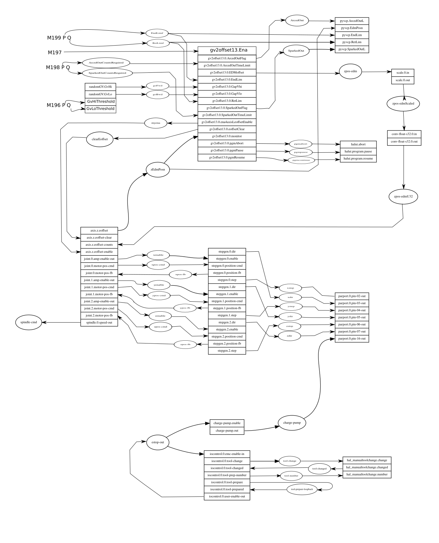

24 Oct 2021 00:33 - 09 Nov 2021 09:29 #224068
by tjtr33
Here's a kit that will help you work in EDM with Linuxnc.
It is for sinker-edm or EDG or HoleDRill EDM.
The edm path is a single vector.
The cut uses the 'external offsets' feature of LCNC.
The kit has a fake 'gap signal' generator so you dont need hardware to test.
This is very much just a beginning'.
Have Fun
TomP

Replied by tjtr33 on topic EDM using external offsets
Have Fun
TomP
