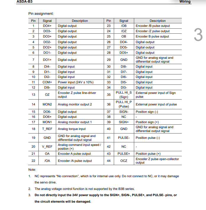

Hello,
sorry for the stupid question, but I'm trying to connect the delta driver version B3-L to the mesa board 7i95 without any success.
I started from the beginning, wiring only the step and pulse signals, but after 1 day I'm still not figuring out the solution.
Any previous experience to set up drivers with mesa board and linuxcnc, please?
Some hidden parameters somewhere in the delta driver to change?
Thanks in advance for any suggestion

Hi Alessandro,
connect as follow
Step - => 41 Pulse -
Step + => 43 Pulse +
DIR - => 37 SIGN -
DIR + => 39 SIGN +
There are no hidden parameters.
Check if Serov on. Perhaps still in the EMERGENCY STOP alarm AL013. You can switch with the Mode button. Or check parameter P0-46 bit 0 = servo ready
Bit 1 = servo on
P2-10 - P17 are the DI input parameters to switch the servo on and off. Check this if the servo is not ready.
But I recommend connecting them in the future. So you can very easily control a safe shutdown.
The factory setting is DI1 Servo on DI8 EMG
This is also described very well in the manual.
Second, parameters P1-44 and P1-45 must be set.
The factory setting is 160,000 pulses / rev. You have to crank for a long time until something happens.
For example P1-44 = 16 and P1-45 = 10 => 1000 steps / rev.
good luck

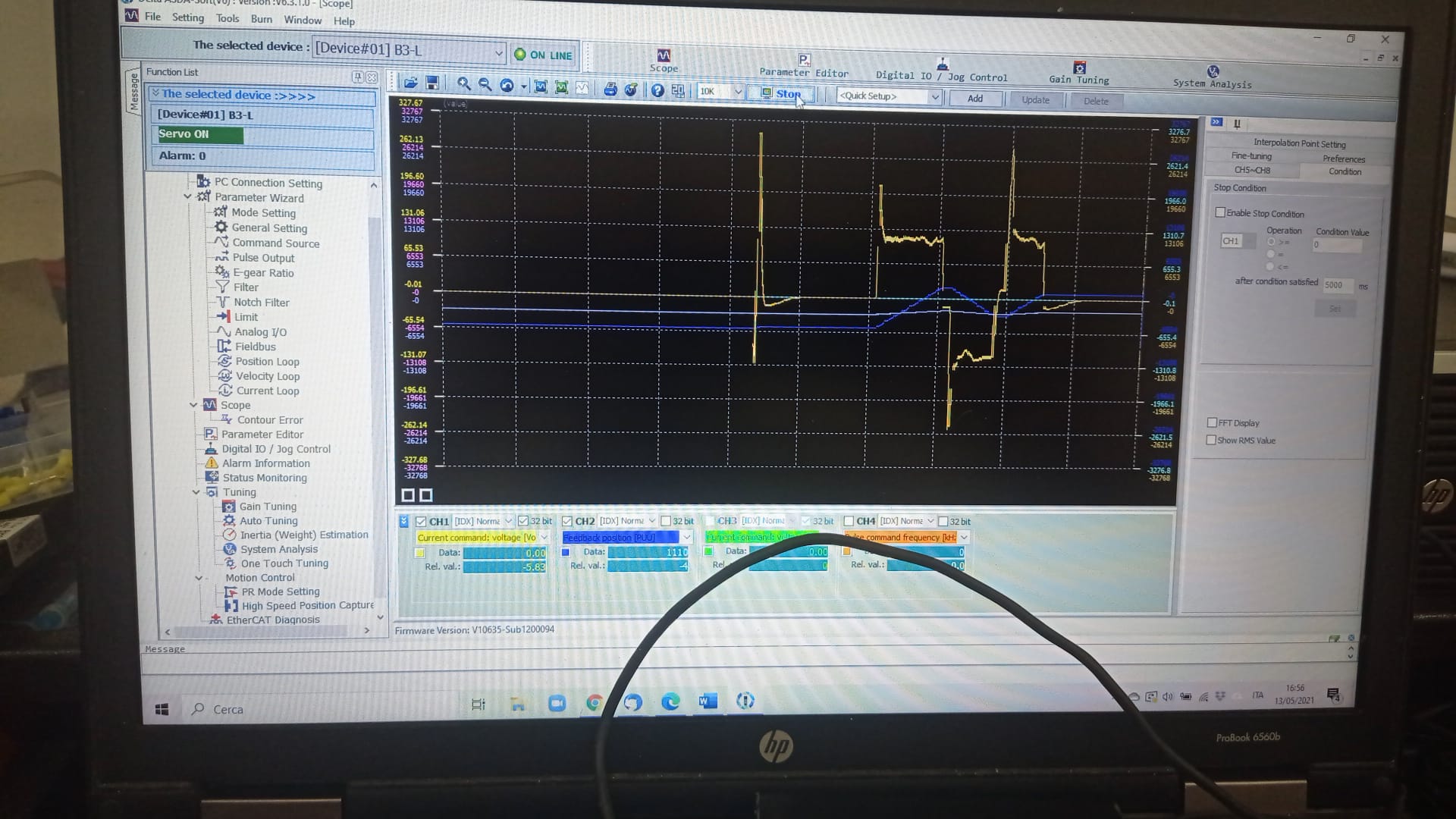

And I switched all the 2-15-17 to 0. The servo was switched "ON" from the parameter 2.030 set to 1, and I was able to jog manually.
Moreover pushing the jog button from linuxcnc and checking with the scope of the Asda software( connected via USB), I was also able to see the pulse and dir signals coming from linuxcnc but the motor continues to stay stopped.

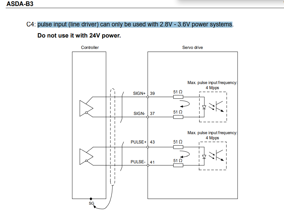

I checked the parameter P-046 that you suggested and I found it "97". I'm becoming crazy because I can't understand if the issue comes from the wiring, or from some delta driver parameters, or from something else coming from linuxcnc. It's really frustrating,
The mesa board give 5V as output and the driver manual write about 2.8-3.6V can be this the issue?
Any other suggestion will be very appreciate

Do you have an alarm on the drive?
You can see and change the status of the DI in the asda software.
And what do you have in the INI?

I have the B2 driver. But check in asda software the input status. You can see if servo on or switch on in this way for test. But i wonder about this 3.6v max
