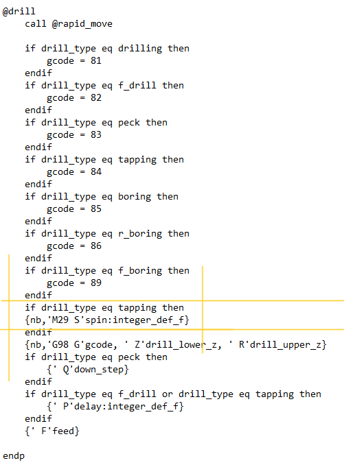

I use a FANUC PP and did some changes to work on Linux CNC based system.
If a want to drill a thread, the Code M29 is used. After research M29 is for syncing spindle and servo motor.
This will give me an error message, so M29 can not be used on a Linuc CNC System?
I also added the GPP-Code.
Is there a different way to drill a thread in Linux CNC?
Thank for your help.

The available g-codes in linuxcnc:
linuxcnc.org/docs/2.8/html/gcode/g-code.html#gcode:g43
The available m-codes :
linuxcnc.org/docs/html/gcode/m-code.html#mcode:m68
Maybe have a look at G33 and G33.1

When I‘m coding
G33.1 Z-5 K0.25
nothing happens.
The spindle is still rotating, but there is no movement in z-direction.
I’m using a ISEL1200-is Frequency Converter. Could there be some problem with the hardware, like its not able to sync?
Thank you for your help

G33.1 (rigid tapping (spindle synchronized motion with return) requires an encoder on the spindle with feedback to LinuxCNC to sync motion.
Your ISEL1200 spindle (1200W / 0.5Nm@22K) doesn't have an encoder and the torque is way to low for rigid tapping.
Not sure which CAD/CAM system you are using, but Fusion 360 e.g. has a "2D Thread" operation to mill a thread.

I have just had a report from another LinuxCNC user that the surprisingly cheap thread mills at
APT
are surprisingly good.
He has run 88 M3 holes with a £17 cutter, where the previous cutter he bought was £120.
Thread milling is a one-line command in LinuxCNC G-code. An M6 x 1 thread 10mm deep cut with a 4mm dia cutter might be:
G0 X2
G0 Z1
G3 I-2 Z-11 P11
G1 X0
G0 Z1
By not having any start or finish points the line is interpreted as "P" full rotations.
