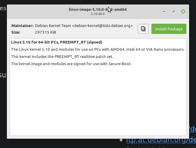

Hi all.
I actually have Linux Mint Mate 4.9.0.13-rt-amd64 Debian 4.9.228-1
I would need to install a PCI Wi-Fi and all the ones I have looked at ask for kernel 5.1 or higher.  From what I'm reading I know that up to 5.10 is available right now and I have a slight idea of ​​what the upgrade would be like but since I have doubts and I don't want to break anything, I prefer to ask for your help.  I would appreciate if someone could tell me about the steps to follow as well as the commands to update the Linuxcnc kernel safely.

It would be like this?
wget ftp.us.debian.org/debian/pool/main/l/lin..._5.10.46-4_amd64.deb
sudo gdebi linux-image-5.10.0-8-rt-amd64-dbg_5.10.46-4_amd64.deb
sudo apt-get update
Last edit: 12 Aug 2021 09:59 by RoberCNC.

12 Aug 2021 11:26 #217600 by tommylight
Replied by tommylight on topic Kernel upgrade
Yes, that is the way to do it, but might need a file with no "dbg" in the file name.
You can safely try it as is, gdebi is very good at folloving dependencies.
On the other side, if i remember correctly, kernel 5.6RT would complain that it can brake support for something or another, so if you get that warning pay attention to it and decide if you can do without whater will be missing, and if you choose not to continue everything will be set back as it was.

12 Aug 2021 11:51 #217603 by RoberCNC
Replied by RoberCNC on topic Kernel upgrade
Thanks tom.
Are you talking about 5.6RT? In the index it goes from 4.9 to 5.10 and in RT that I understand what I need for the machine I only see two, one with the dbg and another marked as unsigned, which seems to be only about 50M.
Maybe I am getting too complicated by entering things that I do not know completely when really all I need is a PCI Wi-Fi that goes well with what I have.
Would you be so kind as to tell me one?

13 Aug 2021 08:28 #217668 by rodw
Replied by rodw on topic Kernel upgrade
You can get the 5.1 kernel using Debian Bullseye as discussed in this thread.
forum.linuxcnc.org/9-installing-linuxcnc...-rip-install?start=0
The thread has been renamed so there is a bit of a preamble but I think we covered it. Bullseye was scheduled for official release tomorrow 14 August
The following user(s) said Thank You: RoberCNC
13 Aug 2021 14:13 #217681 by RoberCNC
Thank you very much for the info Rod. At the moment it seems that I have the kernel 5.10 without having destroyed anything, I will wait to have the PCI next week and I will try, let's cross our fingers.
