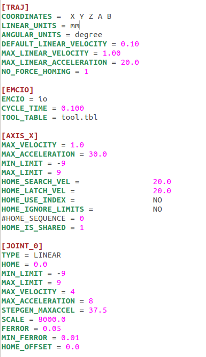

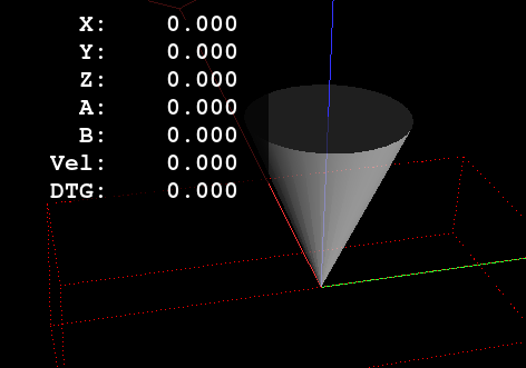

When I modify the in the INI file, linear_ After units, after changing inch to mm, my track interface becomes like this. Is there any way to change it to normal?

You mean the size of the cone?
Can you please post your ini file?

27 Aug 2021 01:33 #218842
by yi2580
Replied by yi2580 on topic Something strange happened to my interface
Yes, I'm talking about the size of the cone.

I think you need to change the values of the max and min limits to match the change to mm.
You can change the cone size as well, see CONE_BASESIZE here:
linuxcnc.org/docs/devel/html/config/ini-...tml#_display_section:
