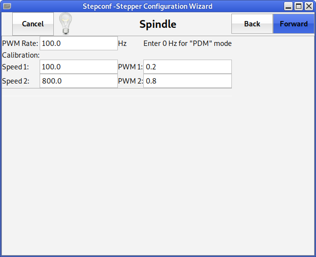

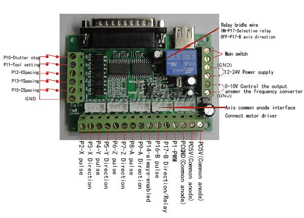

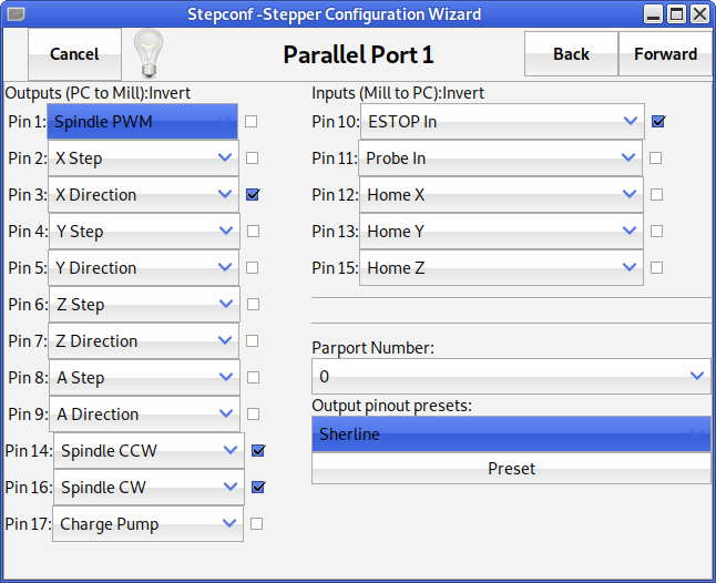

I am using a parallel port breakout board with linuxcnc using pwm on pin 1 to drive the vfd for the spindle.
When I tell it to turn on in the forward direction everything seems to work as expected. Pin 1 reads about 2.5v & the spindle run at about 50% of speed as expected.
If I then stop it & try to run it in reverse the spindle turns on in reverse but only runs at about 25% of speed (instead of the commanded 50%)
When I measure the voltage it is correspondingly lower.
This would seem to be something to do with the software rather than the hardware.
Does anyone have any ideas where to start?
Attached are some photos of my setup & components.

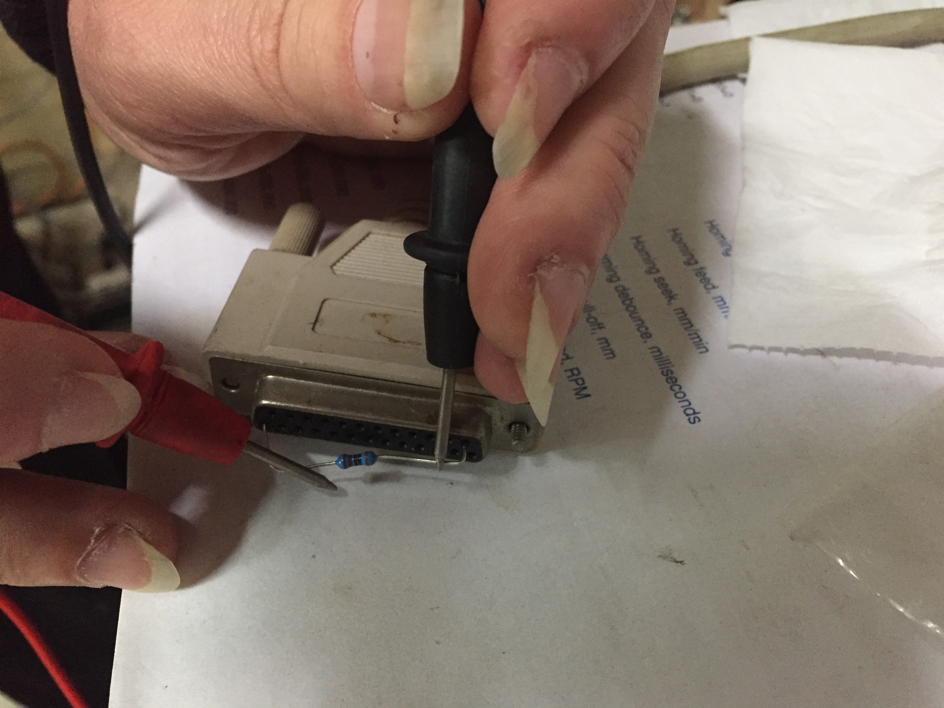

Might not like it but get rid of the BOB, use a 100 ohm resistor on pin 1 and test .

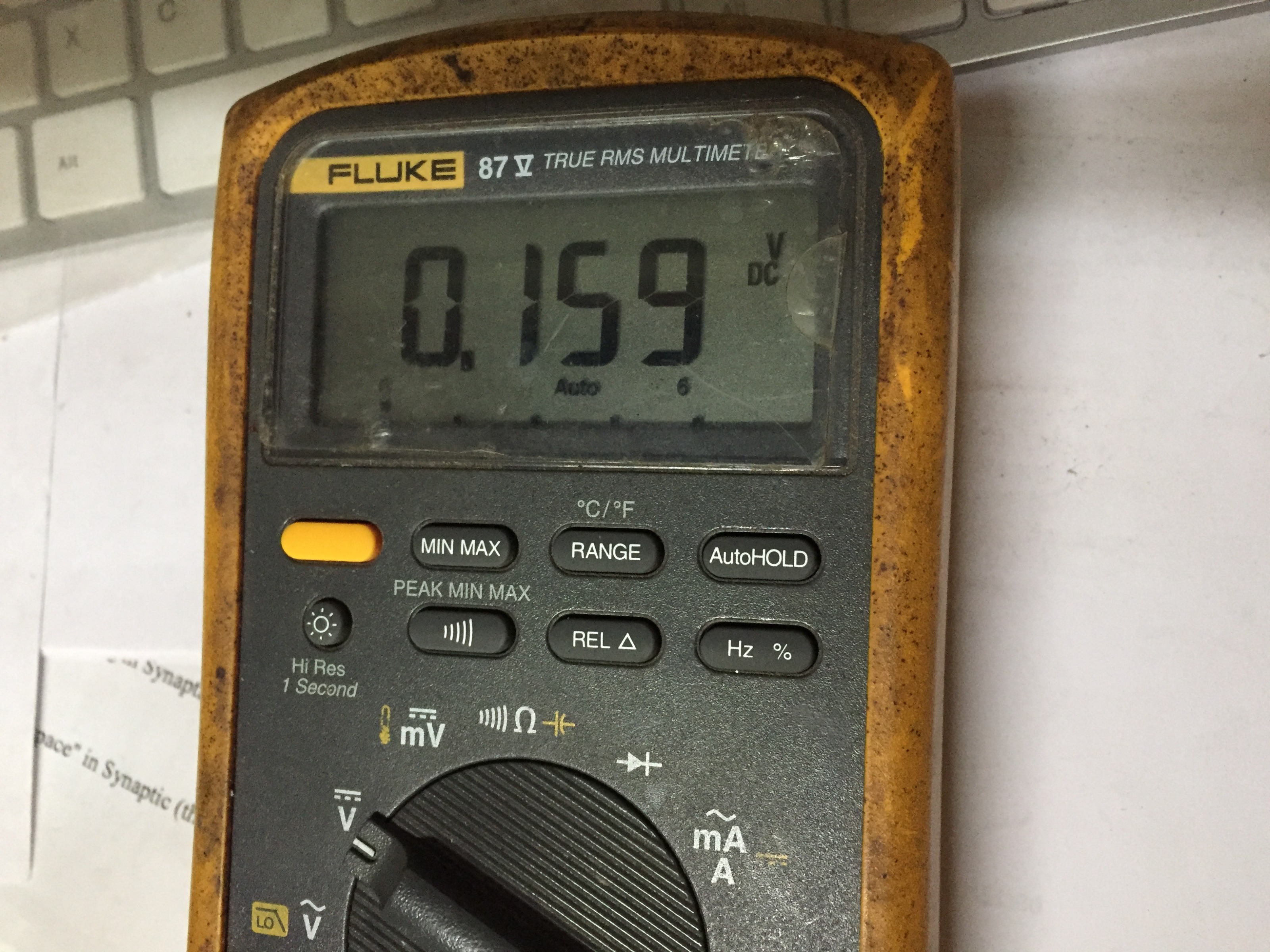

I have tried what you suggested.
I used a 200 ohm resistor between pin 1 & ground & measured the voltage across the resistor.
The results still look the same. A higher voltage in the forward direction than the reverse.
Please see attached photos.

Is the PWMgen set to PWM/DIR (1) mode?
If not, negative spindle speeds will set the PWMgen
to the minimum PWM setting

Yes the mode is correct, but I think this statement will not do the
expected thing with negative numbers:
setp pwmgen.0.offset 0.11428571428571428
Probably the simplest fix is to change:
net spindle-cmd-rpm => pwmgen.0.value
to
net spindle-cmd-rpm-abs => pwmgen.0.value
to
