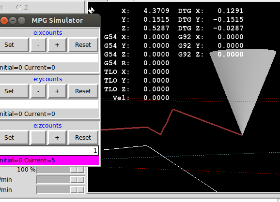

- chen1234
- Posts: 58
10 Feb 2022 10:20 - 10 Feb 2022 10:24 #234483
by chen1234
Replied by chen1234 on topic Does the interface display abnormally when using External Axis Offsets?
I saw in the example sim/configs/axis/external_offsets/eoffsets_demo.ini that when External Axis Offsets is triggered, the interface will display the position of the Z axis synchronously.
linuxcnc.org/docs/2.8/html/motion/extern...l#_eoffsets_demo_ini
