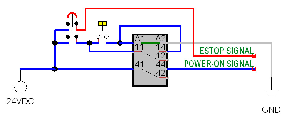

It's completely different than what I was contemplating, but your plan should work fine to keep the power/estop from getting out of sync.
As you say, the power button is only possible if the estop relay is active/closed.
Forgive me if this is obvious to you...
The estop should get 24v to one switch terminal
The other switch terminal should go to one mesa input and the relay coil and one relay contact.
The other relay contact goes to one momentary terminal, and the other momentary terminal to the other mesa input.
Hope it works out!
EDIT
It just occurred to me that this probably isn't going to work, because halui.machine.on needs a continuous signal (not just a blip). And leaving the momentary connected to a toggle function (to make sure it stays on) will get it out of sync. Consider the sequence:
I think you need to use a different relay connection scheme or embrace the joys of Classic Ladder.
Here's a very simple DPDT relay circuit to accomplish what you want. The relay will provide the "machine-on" signal, not the momentary button directly.
Again, forgive me if I'm being Captain Obvious but I could see the toggle function causing some head-scratching and troubleshooting.
-Ralph
-Ralph

I have managed to solve my problem with the simplest of solutions
The combination of a "and" and a "toggle". by feeding both the momentary and the estop into the toggle i fix the problem.
Thank you everyone for your suggestions and assistance
net external-machine-on <= hm2_7i76e.0.7i76.0.0.input-21 => and2.0.in0
net estop-ext <= hm2_7i76e.0.7i76.0.0.input-04 => and2.0.in1
net stuff toggle.0.in <= and2.0.out
net pwr-btn toggle2nist.0.in <= toggle.0.out
net tog-on toggle2nist.0.is-on <= halui.machine.is-on
net pwr-on halui.machine.on <= toggle2nist.0.on
net pwr-off halui.machine.off <= toggle2nist.0.offThe combination of a "and" and a "toggle". by feeding both the momentary and the estop into the toggle i fix the problem.

and2 in to a toggle? That's really, really clever - I'll have to remember that trick.
Thanks for the update and sharing.
