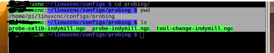

01 Jun 2022 01:00 #244332
by re_relentlessly
Replied by re_relentlessly on topic Tool Length Probe - SUBROUTINE_PATH
Attached a screen capture, looks right to meDo the custom subroutine files need to be relative to the ini in some special way (only in directories below, only in same directory)?
Is it possible that one simply cannot have custom M codes above 199? I though it was possible.
Am I missing some component that needs to be loaded?
Hal snippet below showing what modules that are being loaded
user@cnc:~/linuxcnc/configs/probing $ pwd
/home/pi/linuxcnc/configs/probing
user@cnc:~/linuxcnc/configs/probing $ ls
probe-calib-indymill.ngc probe-indymill.ngc tool-change-indymill.ngcIs it possible that one simply cannot have custom M codes above 199? I though it was possible.
