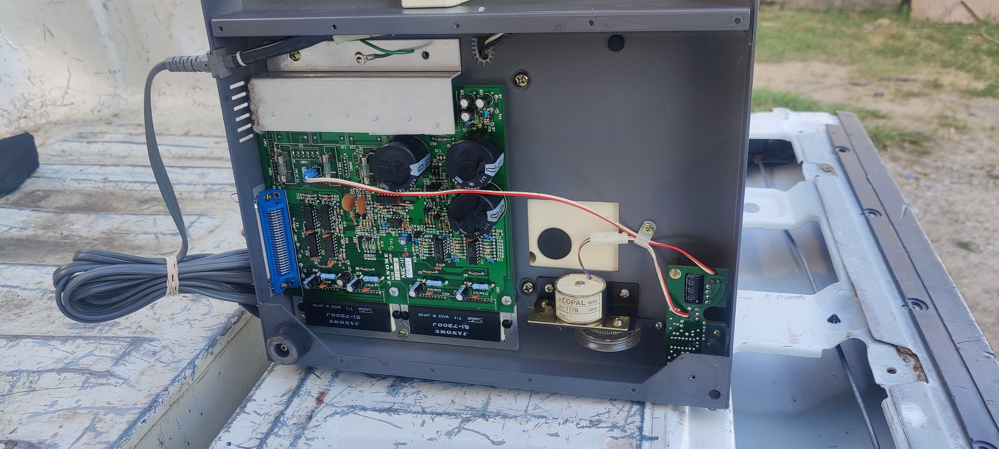

So i have an embroidery machine that is missing it's control. I'm debating making it into a Linux cnc one.
Thoughts? Any other options you might recommend instead? is a partial teardown
EDIT: So looking at it I have the following I would need to control. All looks somewhat simple although the devil is in the details.
Outputs
X stepper Motor
Y stepper Motor
Sewing machine motor.
Tension solenoid
Bobbin winding motor (Likely just a switch as it does not need to be involved in the CNC part)
Sensors. All look to be the non contact style where you slide something between them. Forget the name offhand.
X homing
Y homing. (Not positive it exists but x does so y should.)
Encoder disk.
2 needle position sensors. Not sure why both but 1 is longer than the other
Top thread lost sensor
Bobbin sensor (Position or thread lost. Assuming thread lost for now.)
Outputs
X stepper Motor
Y stepper Motor
Tension solenoid
X homing
Encoder disk.
Last edit: 17 Jul 2022 03:38 by Birdman3131.

Can you deal with an arduino?
Making a simple signal generator and testing pins 2 and 4 on that port is enough to prove it is doable or not.
Take a picture of that board and attach it here.

17 Jul 2022 02:14 - 17 Jul 2022 02:15 #247531
Replied by tommylight on topic Embroidery machine retrofit.
Cr@p!
That is a 50 pin centronics port, not a 36 pin one.
That complicates things, a lot. Reverse engineering ?
Or retrofit
Edit:
still i would try with a signal generator, ESP will do just fine for that, blinky with faster rate.
Or retrofit
Edit:
Last edit: 17 Jul 2022 02:15 by tommylight. Reason: more info

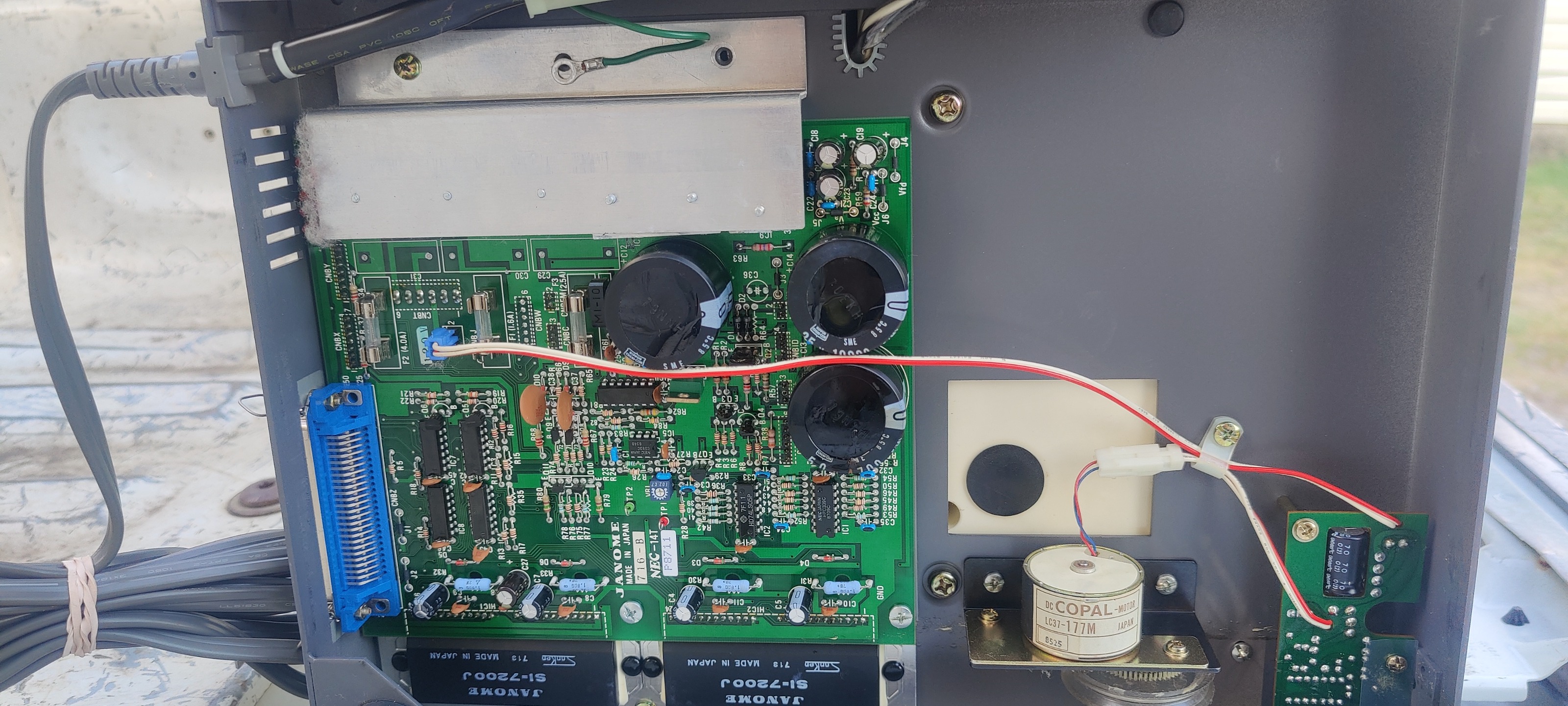

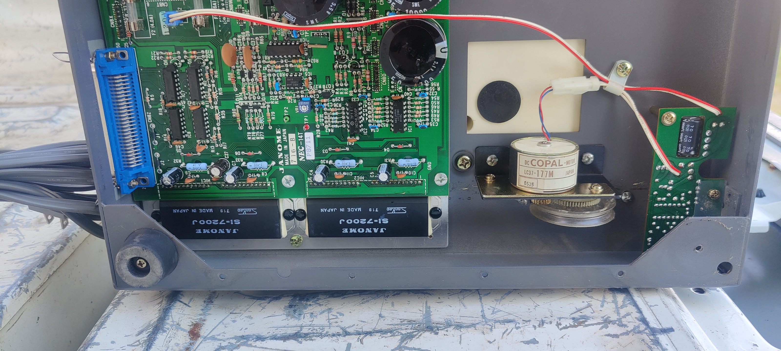

17 Jul 2022 05:02 #247537
by arvidb
Replied by arvidb on topic Embroidery machine retrofit.
Janome is still around, maybe it's worth it to contact them and ask for data sheets on either the board itself (716-
or the driver IC:s (SI-7200J)? A long shot, but getting data sheets would make things much easier.
I think pin 2 and 4 was assuming a standard 36 pin Centronics connector? Given the 50-pin port, I think you have to do some reverse engineering before hooking up a signal generator. Some things to start with:
* Which pins are connected to GND? (Measure continuity between pins and the PCB ground plane, marked as GND in lower right corner of pictures).
* Which pins are connected to power? (Power supplies and cables are not visible in the pictures; I assume that these are on the other side of the steel plate and connects to the underside of the board?) Find any external power supplies that connect to the board and measure the voltage(s) they supply, then see if you can find additional power regulators on the board. I.e. identify the power rails that exist on the board, and map out pins on the Centronics connector that connect to these.
* Which pins connect to pins on the driver IC:s? These are the ones you might want to hook up to a signal gen to see if you get motor movement. It might be tricky though if there are e.g. enable inputs that needs to be activated.

17 Jul 2022 05:24 #247538
by arvidb
Ha! A search for Sanken 7200 gives a few results:
A - pin 7
/A - pin 6
B - pin 12
/B - pin 13
Power down (active high) - pin 9
GND - pins 8, 3, 6
Motor coils - pins 2, 4, 17, 15
Vcc - pin 10
Pin 11 seems to be some kind of clock input? Connects to a 555 circuit in the data sheet. Maybe for a high side charge pump? Anyway, finding which pins connect to A, /A, B, /B and figuring out if the disable input needs to be deactived through some Centronics pin should do the trick!
A - pin 7
/A - pin 6
B - pin 12
/B - pin 13
GND - pins 8, 3, 6
Vcc - pin 10
