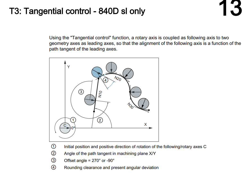

So this is a bit of a off the wall question... I'm working with a friend that is wanting to make a CNC spray painter for painting the numbers on the highschool football field.. He has the placement situation figured out, and is planning on using an X/Y frame from an old CNC router to move the paint head. The paint will be supplied by a Wagner Airless sprayer, with paint flow controlled by a solenoid valve. All this is really pretty simple until we hit the gotcha moment....
The spray tip is a fan shaped pattern. If you control with simple X/Y moves, you'll have the same effect as writing with a calligraphy pen, super weird looking letters. For it to work correctly, the fan shaped output of the nozzle must always be at a 90 degree angle to the direction of travel. Not so hard really, we can use a live swivel coupling to allow the nozzle to rotate and a stepper to control it as a C axis in LinuxCNC. It would be easy to incorporate this into the G code for straight line (G1) moves. The problem comes in when we try to do arcs, like for a number 2, 3, 5, 6, 8, 9, or 0... The direction of travel is not in a particular direction, but rather an arc.... I have no doubt LinuxCNC can handle the coordinated movement of the various axis's. The issue is, how to get the input into it to knno what moves to do? Is there anyway in HAL or otherwise to have a control that keeps a rotary axis at a fixed angle to the current direction of movement? Or will I need to CAM this out using tiny G1 moves with slight corrections in the C axis for each move?

Replied by troy on topic Orienting a rotary axis to be perpendicular to direction of travel. Possible?
siemens 840Dsl has a function called "Tangential control". But I'm afraid linuxcnc doesn't have this similar function
My suggestion is: post process the G code that controls the movement of the paint, discrete the non-linear movement into micro segments, and specify the corresponding rotation axis angle according to the tangential direction of the micro segments. This should be a faster and more convenient implementation method.

Option 1 - Tangential orientation can be handled in a post processor. Here's an example on github for a Fusion 360 tangential knife.
github.com/jejmule/PostProcessor
Option 2 - External offsets. I can't give you a cut-paste recipe, but there are some clever folks here who have done some remarkable things with external offsets. Like lathe cam turning.
linuxcnc.org/docs/master/html/motion/external-offsets.html
External-offset-per-angle could approximate a continuous C-axis tracking. Probably good enough for spray-painting grass:
linuxcnc.org/docs/devel/html/man/man9/eoffset_per_angle.9.html
Option 3 - get or make a different tip. i.e. circular pattern. Either spray pattern (fan or circular) will have lighter regions at the edges so some experimentation with pass overlap would be in order.

24 Jul 2022 17:54 #248197
Replied by andypugh on topic Orienting a rotary axis to be perpendicular to direction of travel. Possible?
A number of CAM packages (SheetCAM for example) offer a tangential knife mode.
I wrote a kinemetics module many years ago that outputs the current heading, but it didn't really work as well as I had hoped (it was really meant for kerf compensation). Its limitations might be less critical here.
I keep suggesting a filter file as the solution to this. But I don't know if anyone has written one. I don't even know if I have written one. I think I have, and lost it....
The G93 filter here is very close to what would be needed, though It just needs a different bit of maths to work out the direction of travel.
www.forum.linuxcnc.org/38-general-linuxc...r-me?start=10#120524
