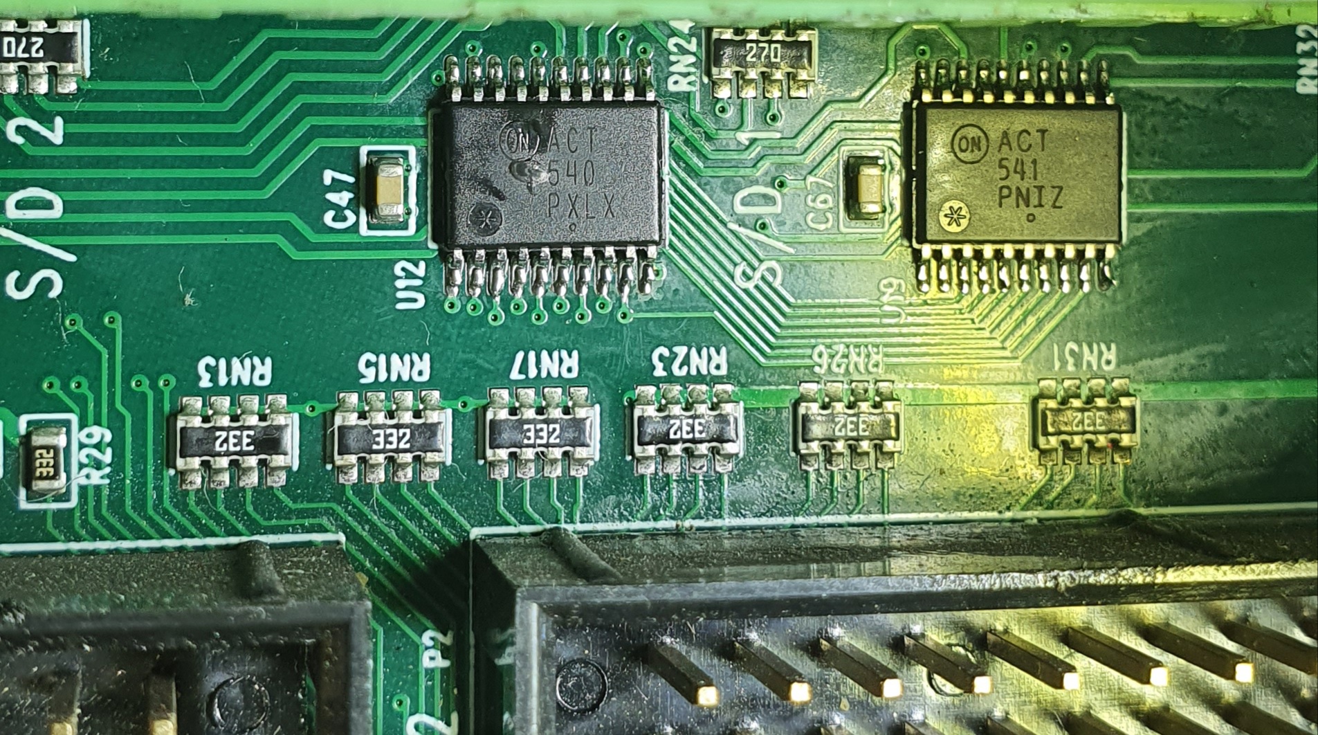

Hello,
I have spent today about 10h to find out why my axis motors (chinese 400w integrated servo motors).
I installed 2 different Linuxcnc installer versions, but it didn't helped. I have now LinuxCnc 2.9 installed and everything is working fine expect the both axis motors.
What I found out while trying to find the problem:
My proximity homing switch of the X axis wasn't working, so I checked the wiring. I have a control panel with mpg wheels and quiet many buttons buttons, but the control panel was mounted so that it squeezed couple of input/output wires. I fixed it and the proximity switch is working.
When starting linuxcnc I am getting no errors.
The motors are powered.
Without your help the next thing I would try is to connect both axis to the 2 other axis terminals on the 7i76e that are unused and do the changes in the HAL.
I just don't get it why after reinstalling linux/linuxcnc and using the exactly same config as previously used my motors are not spinning.
I am thinking if I damaged something on the 7i76e because of squeezing the wires with the control panel. I am not 100% sure, but it could be that the 24v that alao supplies the proximity switches had a short circuit due to the squeezing of the wires.
If that happend, what could have been damaged and how could it be diagnosed?
I am helpless to be honest.

When everything is powered, try spinning the motor shafts by hand, they should not move.
If you have a DVM or a scope, check the step/dir pins on the Mesa if they are outputing any voltage while not jogging and while jogging.

Thanks.
- Motor shaft not possible to spin
- checked with DVM if anything happends on the axis terminal pins on the 7i76e while in homing sequence, but no changes happend. If i remember correctly 2 or 3 pins had 4,95 V or so. I will check it on tomorrow again to give more precise information.
I could have mentioned that in the post earlier, sorry for that.

I did some research and currently (without checking the step/dir pins) i think my step/dir drivers are damaged.
(www.forum.linuxcnc.org/38-general-linuxc...55-repair-7i76e-card)
@PCW wrote:
Thanks in advance.
@PCW wrote:
I have someone who already ones repaired my 7i76E, so i would like to order those drivers. 74ACT540DTR2G is in stock, but unfortunately 74ACT541DTR2G is not available anywhere. Is there a replacement driver that could be used?Yes, U12 and U19 were likely damaged
These are a 74ACT540DTR2G (U12) and 74ACT541DTR2G (U19)
Thanks in advance.

Some news:
I checked the voltage between Dir+ and Dir-, as well as between Step+ and Step- . Result: 0.02 - 0.04 V, no matter if Linux is on or.off, or if the homing process is active.
One of the drivers (74ACT540DTR2G) is definitely damaged as can be seen on the pictures. The ACT541 driver on the right side looks optically alright, but that is not a guarantee that its okay, right?
The guy who ones repaired my 7i76e did just send me this as replacement for MC74ACT541DTR2G : a.aliexpress.com/_EyLF0vb
Actually I am.trying to find something in Europe that can arrive in couple of days, but if I have to order from Aliexpress then I will buy the MC74ACT541DTR2G & MC74ACT540DTR2G.
