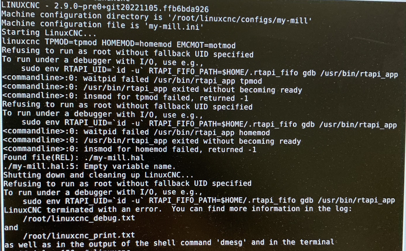

Cant run Sample Configurations

Something wrong with the attachment, please upload the pictures here on the forum, there is a button "attachments" under the editor.

Sorry now there should be a picture

Replied by andypugh on topic Cant run Sample Configurations
Did you build LinuxCNC from source?
If so, then I suspect that you forgot the "sudo make setuid" step.,
If not, then it's a more perplexing question.
Looking more carefully, you are logged in as root.
Some info here, and the same problem.
www.forum.linuxcnc.org/49-basic-configur...4-and-7i76e?start=10

Replied by tommylight on topic Cant run Sample Configurations
Reinstall is the only option, and this time when asked for a ROOT password, just click next. But do add a USER password.
A lot of software will refuse and/or complain when run as ROOT, it is a full rights administrator account.
Edit:
Please notice on the picture, Linux is running with the ROOT user account.
Edit:
I am a bit confused, because the LinuxCNC installer doesn't offer the option to create a root password (it is pre-seeded as blank)

Also i am sure he is running as ROOT, but i have no idea how or why.
I am sure of that, i have 2.8.4 official ISO on one of the laptops.I am a bit confused, because the LinuxCNC installer doesn't offer the option to create a root password (it is pre-seeded as blank)

You should not need to reinstall, just add a normal user if none exits, logout as root and login using that username and pw
