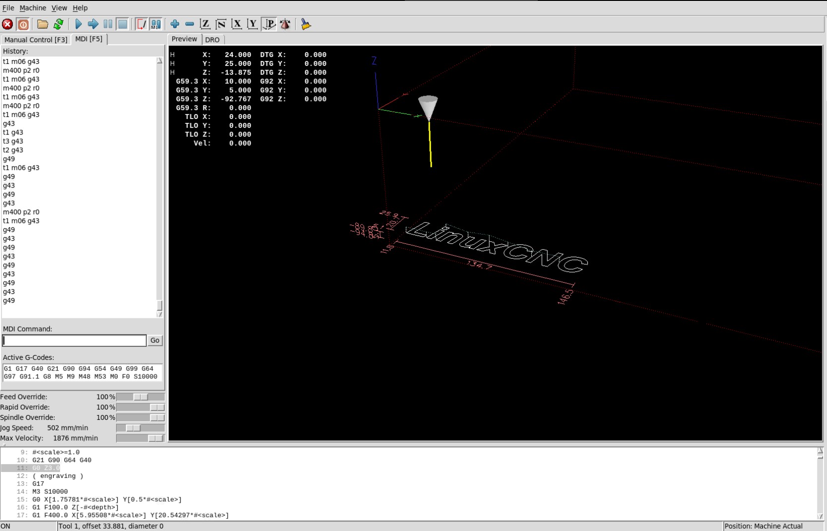

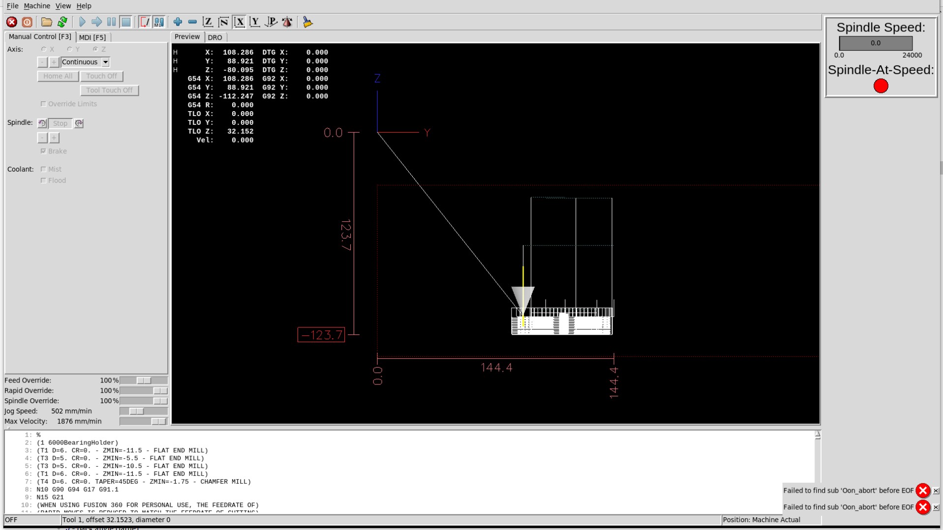

Hello,
I am having a issue I don't understand with Linuxcnc and My Z axis.
I load a gcode program generated from fusion360. I home the machine, I set the g54 offsets. I then load a tool and set the tool offset.
but when I go to run the program I get an error about the Z axis being outside the minimum.
After investigate a little, I noticed that the origin point in the gcode (as seen in the attached image) is outside the machine volume. But I have no idea why. Can anyone help me understand why the gcode origin/start point is in a seemingly random spot?

I Have done some more testing,
It appears the the gcode origin/start position being offset from the work envelop is order of operation dependant.
If I setup the tool length offset first (t1 m06 g43) and then load the program, and finally set the g54 work offset, the gcode origin stays fixed to the work envelope corner, instead of ending up beside it
So i still do not know what is causing this issue, but the order in which i:
1. set the work offset (g54)
2. set the tool offset (t1 m06 g43)
3. load the gcode
changes the outcome.
3. load the gcode

z0 is higher than the limits by 32.152. Limits 0 -123 is more than in INI (MAX_LIMIT = 0.0 MIN_LIMIT = -105.0).

gitin: yes you are correct, and it just so happens that the offset is exactly the tool length offset

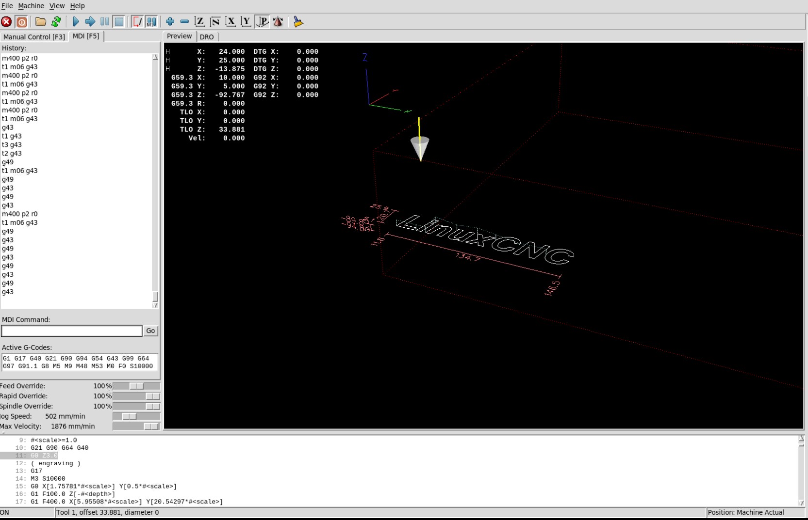

even more testing
I have now narrowed it down to g43/g49, turning off tool length compenstation "fixes" the problem.
So as soon as the g43 gets applied the gcode z position jumps upwards the tool length offset.
but then if via MDI I run g49, it snaps back into place at the machine top corner.
Why is tool length compensation moving the gcode start postion (0,0), outside the bounds of the machine limits?

Out of curiosity I disabled the M6/M400 remap that I was using.
I then loaded a tool via t1 m06 g43. and the weird offset still shows up
running g49 in MDI, corrects the offset
Can anyone explain why the origin gizmo moves when tool offsets are loaded? is this normal?
