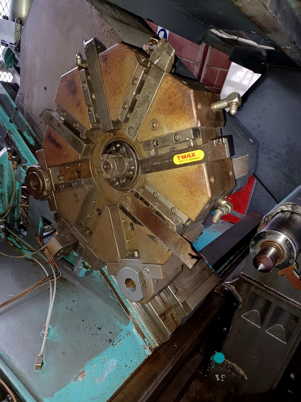

Starting this thread to help create a logic component for a Mazak ATC.
The turret uses a Geneva-mechanism with a AC motor .For position feedback it uses three proximity sensors that pick up on a encoder wheel .
The position feedbacks are as follows .
Pos 1: 0 1 0
Pos 2: 1 1 0
Pos 3: 1 0 0
Pos 4: 1 0 1
Pos 5: 1 1 1
Pos 6: 0 1 1
Pos 7: 0 0 1
Pos 8: 0 0 0
Outputs to the turret are as follows :
1. Turret unclamp 1: Moves the turret from clamp to unclamp when active and vice versa.
2. Turret unclamp 2:Doesn't do anything by itself ,but when this is not active turret unclamp 1 does not work .(Sort of a safety ?)
3. Turret rotate forward
4. Turret rotate reverse
Inputs to the turret are as follows :
1.Tool position 1
2.Tool position 2
3.Tool position 3
4.Turret clamped position
5.Turret unclamped position
6.Index sensor
7.Turret pressure down (Goes high when turret unclamp 2 is active)
I will post my pin assignments as soon as I get back to my workshop .

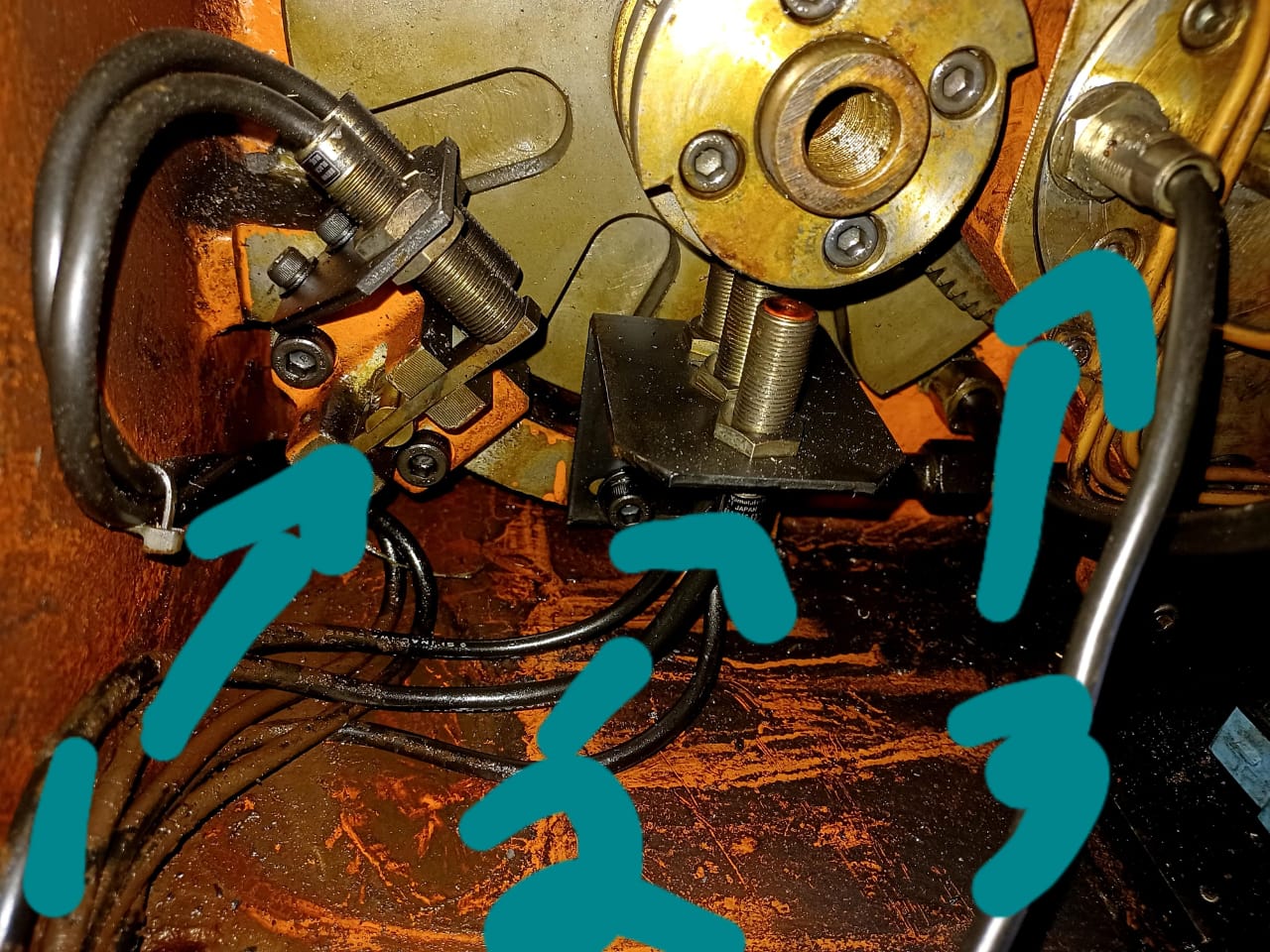

On the attached image the subscripts are as follows:
1. Turret Clamp and Unclamp position sensors
2. Turret position sensors 1 - 3
3. Index sensor
3. Index sensor

17 Mar 2023 16:42 #266923
by dctrytsman
Replied by dctrytsman on topic Mazak QT20 Tool changer
Another photo of the tool changer it self.

does the index go true every revolution of the motor???? if so, is it at the end of the turret movement cycle ??
or what I'm trying to ascertain is, how does the index correlate to the position switches.
and this doesn't look to terribly complicated to modify my existing tool changer program for the mazak. the big problem i see is the lack of sufficient position decoding switches to do error checking of the turret sensors.
a 4th wheel at the end shaft that is on in position in 1 and off in position 2 3 4 5 6 7 8 would allow me to put in a error checking routine to verify the switches work properly.
I'll put together a rough draft with modifications tonight.

I am not 100% sure what the index sensor picks up on .Looking at that first photo you will see anther slotted wheel that the encoder wheel is connected to ,this wheel has 8 pick-up slots in it .The sensor seems to go true at the end of each cycle .I will confirm this on Monday when I'm back at work .

i need to know how that index sensor works, I'm leaning towards it actuating lock 2 on the turret to prevent roll back etc between engagement

The index sensor goes true when a tool is in position ,and goes false in between every tool change .
