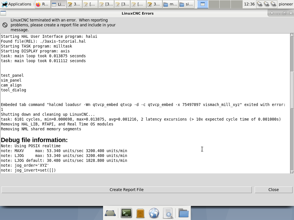

show vismach simulation in qtvcp tabs (axis)
- fery15sty
- Posts: 88
- Thank you received: 12
07 Apr 2023 22:06 #268580
by fery15sty
show vismach simulation in qtvcp tabs (axis) was created by fery15sty

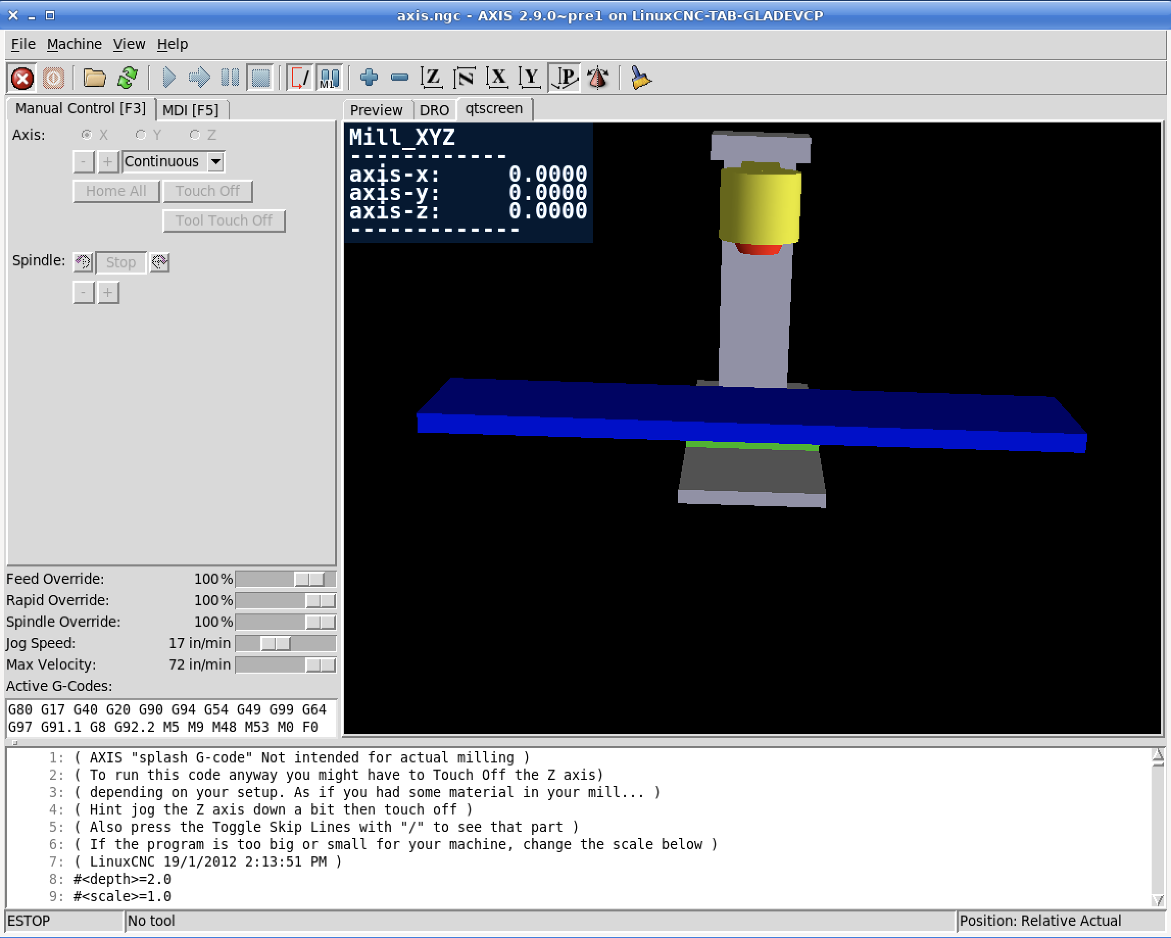

Replied by phillc54 on topic show vismach simulation in qtvcp tabs (axis)
This is how it is done in the 2.9 and master sim configs:
github.com/LinuxCNC/linuxcnc/blob/2.9/co...cp/qtvismach_tab.ini

08 Apr 2023 01:18 #268589
by phillc54
You can change your LinuxCNC sources to the Buildbot.
buildbot.linuxcnc.org/
The docs are a bit behind so just change master-rtpreempt to 2.9-rtpreempt.
The following user(s) said Thank You: fery15sty
