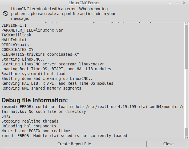

Hi
I updated the real time and now the linuxcnc give the " real time system did not load " .
what should I do ???

Replied by tommylight on topic real time system did not load
Reboot, hold down Shift key, choose RTAI kernel, press enter.
