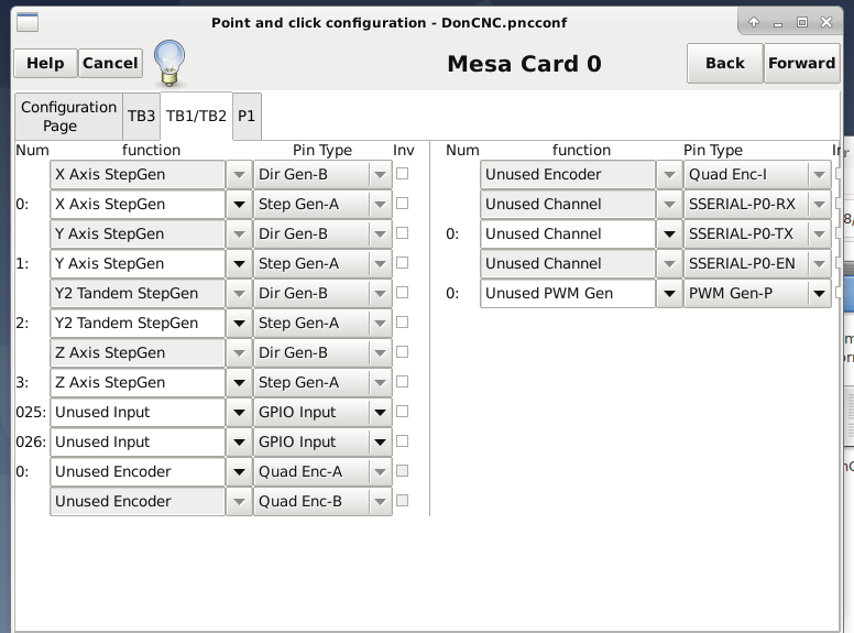

0 X Axis StepGen
1 Y Axis StepGen
2 Y2 Tandem StepGen
3 Z Axis StepGen

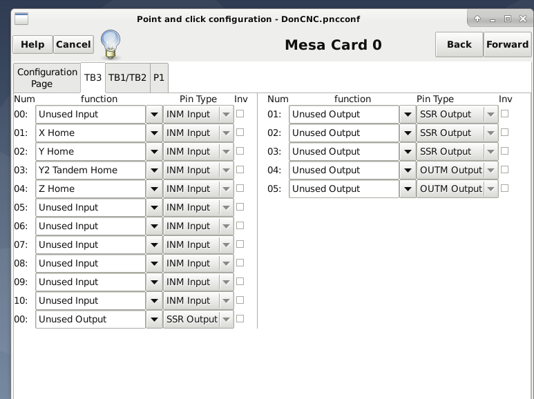

TB3 :
0 unused
1 X Home
2 Y Home
3 Y2 Tandem Home
4 Z Home

TB1/TB2 function:
0 X Axis StepGen
1 Y Axis StepGen
2 Y2 Tandem StepGen
3 Z Axis StepGen
TB3 :
0 unused
1 X Home
2 Y Home
3 Y2 Tandem Home
4 Z Home
