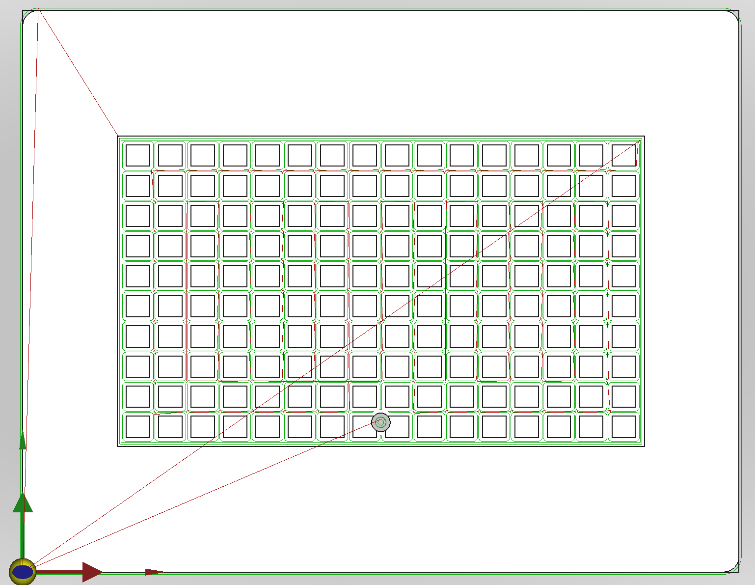

Here's what my path looks like in FreeCAD:

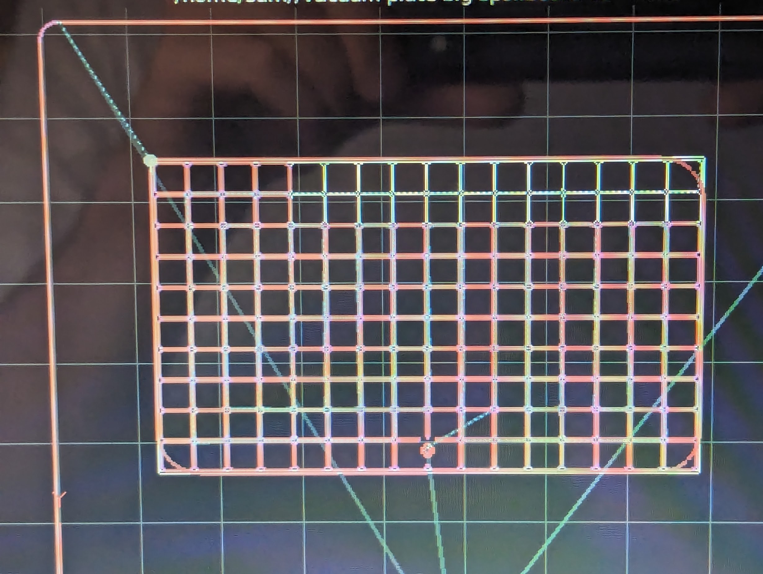

Here is what the machine says it will do (note that I made this picture too late, when the first incorrect traced path was already removed from the view; but you can still see that the later chamfering path had the same problem, just with a smaller radius):

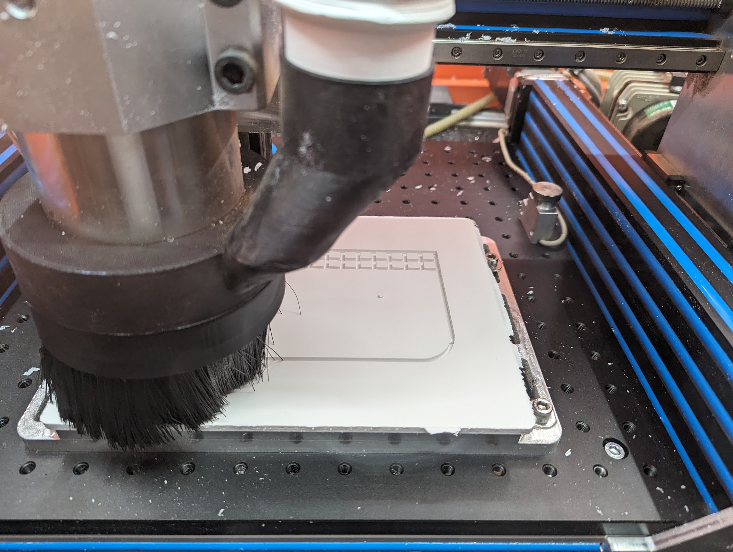

And here is what the machine does:
As you can see, what is supposed to be a square path becomes an arc.
Interestingly, the gcode preview shows the intended path correctly, but the pink line tracing the actual path is shown rounded, too.
Here is the relavant part from the gcode that is supposed to make the outer square:
(Pocket_Shape002)
G0 Z5.000
G0 X199.250 Y139.250
G0 Z3.000
G1 X199.250 Y139.250 Z-3.000 F2000.000
G1 X31.750 Y139.250 Z-3.000 F5000.000
G1 X31.750 Y41.750 Z-3.000 F5000.000
G1 X199.250 Y41.750 Z-3.000 F5000.000
G1 X199.250 Y139.250 Z-3.000 F5000.000
G0 Z5.000
So the machine never actually attempts to drive to this point:
Note that I added G61 after the problems a year ago:
RS274NGC_STARTUP_CODE = G17 G21 G40 G49 G61 G80 G90 G94 G97 G98
My full machine config is here:
github.com/knipknap/cutty
Last edit: 17 Jun 2024 20:24 by knipknap.
