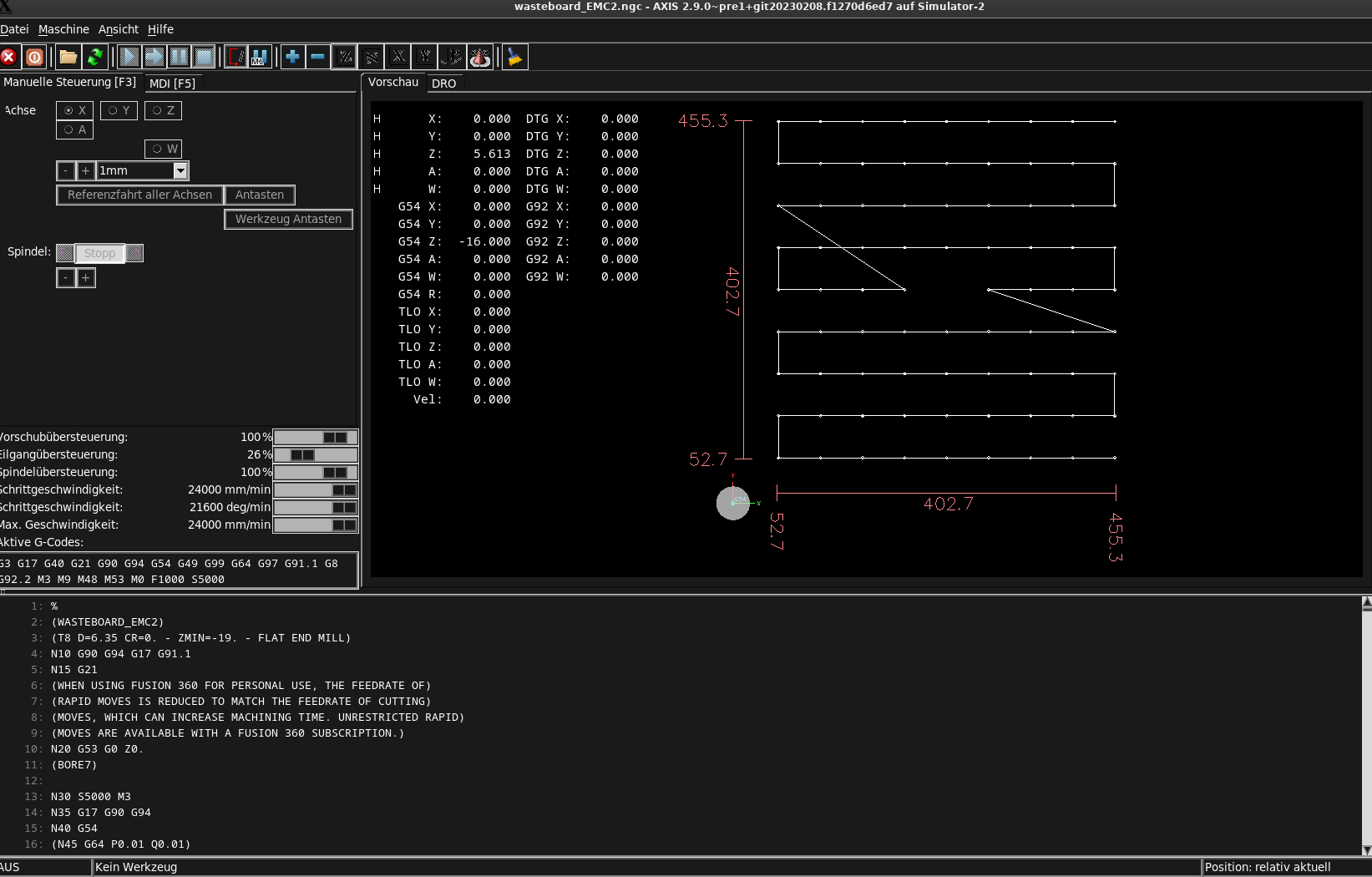

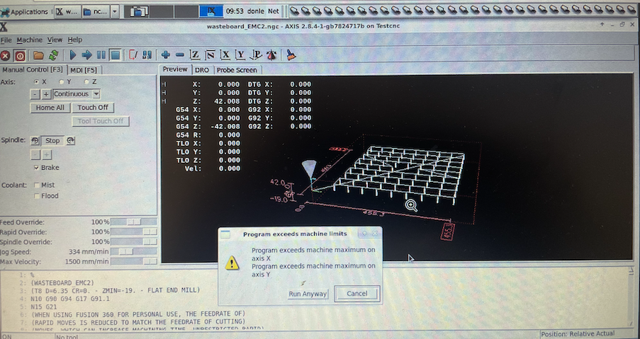

My X and Y limit set at 510x510mm in the .ini and cut area only 454x454 only . However, when I run the operation it was not happy with my limits. Any idea?

Looks well here. Really odd.
Is there any reason why you set your home position to -2.0 and your min_limit is set to -0.01.
I wonder that you don't get alarm after zero return?

I was able to execute the same file now. However, I don't know the reason why it is working. Here is what I did.
- Turn on the machin
- Homing done, then touch off immediate at the same homing posistion.
- Load the ngc file.
- Click play after got the exeed limit error with a "proceed any way" message.
- Click OK to proceed; machine ran then stop with exeed limit error.
- Next, I performed a touch off again at the current position; I then home the CNC again.
- Here is when the magic occured.
- My G54 x,y on the screeen preview changed to -454.000
- I can click Play without any error.
