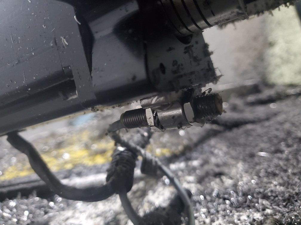

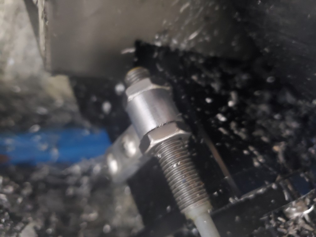

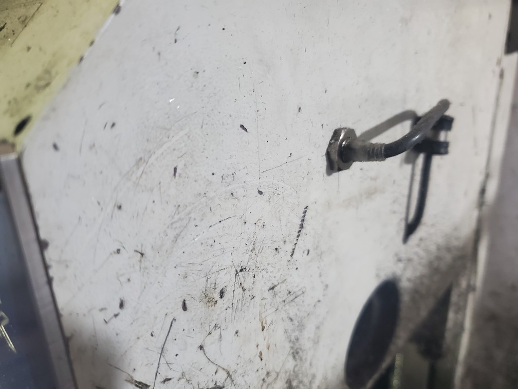

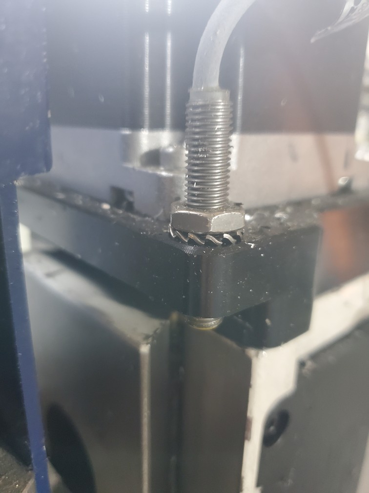

Lol what? Did LinuxCNC turn into the penny CNC conversion alternative? Most people are working with a manual machine costing about $2500 and adding another $2k-5k in conversion parts. $100 for some prox switches are too much? Just did a quick check on Ebay and brand new Turcks are going for $35ea.....is that really too much for a quality part?
So if you made the statement "cheap, improperly spec'd inductive proximity sensors work like shit" I'd certainly agree. You just said inductive switches in general, which is not true at all.
Just so ya know I'm not trolling, these are all of my axes limits and the spindle index installed on the head. I paid $70 for 10 of these switches brand new a couple years ago on Ebay and I still have 4 left, so there's nothing too crazy about any of it.
