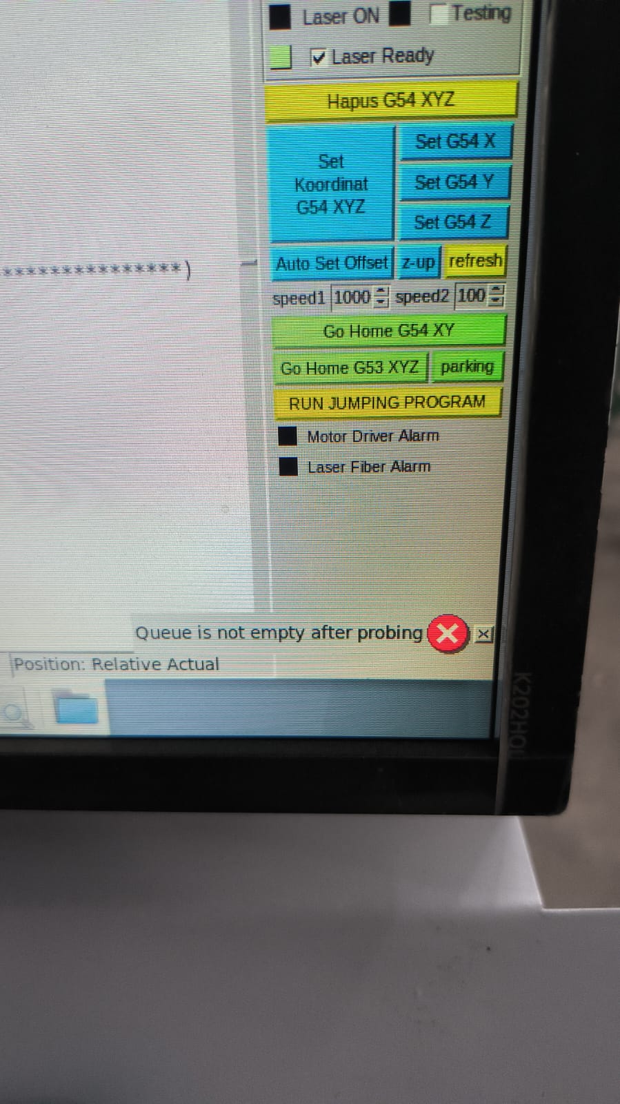

22 Jan 2024 07:37 #291314
by fery15sty
How to fix "Queue is not empty after probing" was created by fery15sty
- Posts: 21985
- Thank you received: 7484
22 Jan 2024 07:50 #291318
Replied by tommylight on topic How to fix "Queue is not empty after probing"
What routine are you using for probing?
Config files?
When you say "floating head" is that where the Z axis moves down till it touches the material to trigger the switch?
Config files?

- fery15sty
- Posts: 88
- Thank you received: 12
22 Jan 2024 08:44 - 22 Jan 2024 08:54 #291323
by fery15sty
Replied by fery15sty on topic How to fix "Queue is not empty after probing"
Yes, I use G38.2 to find material for cutting.
M130 (activated motion.probe-in)
G38.2 Z-10 F800 (probe motion)
M131 (deactivated motion.probe-in)
M3 S1 (THCUD system floating contact)
(cutting code)
(cutting code)

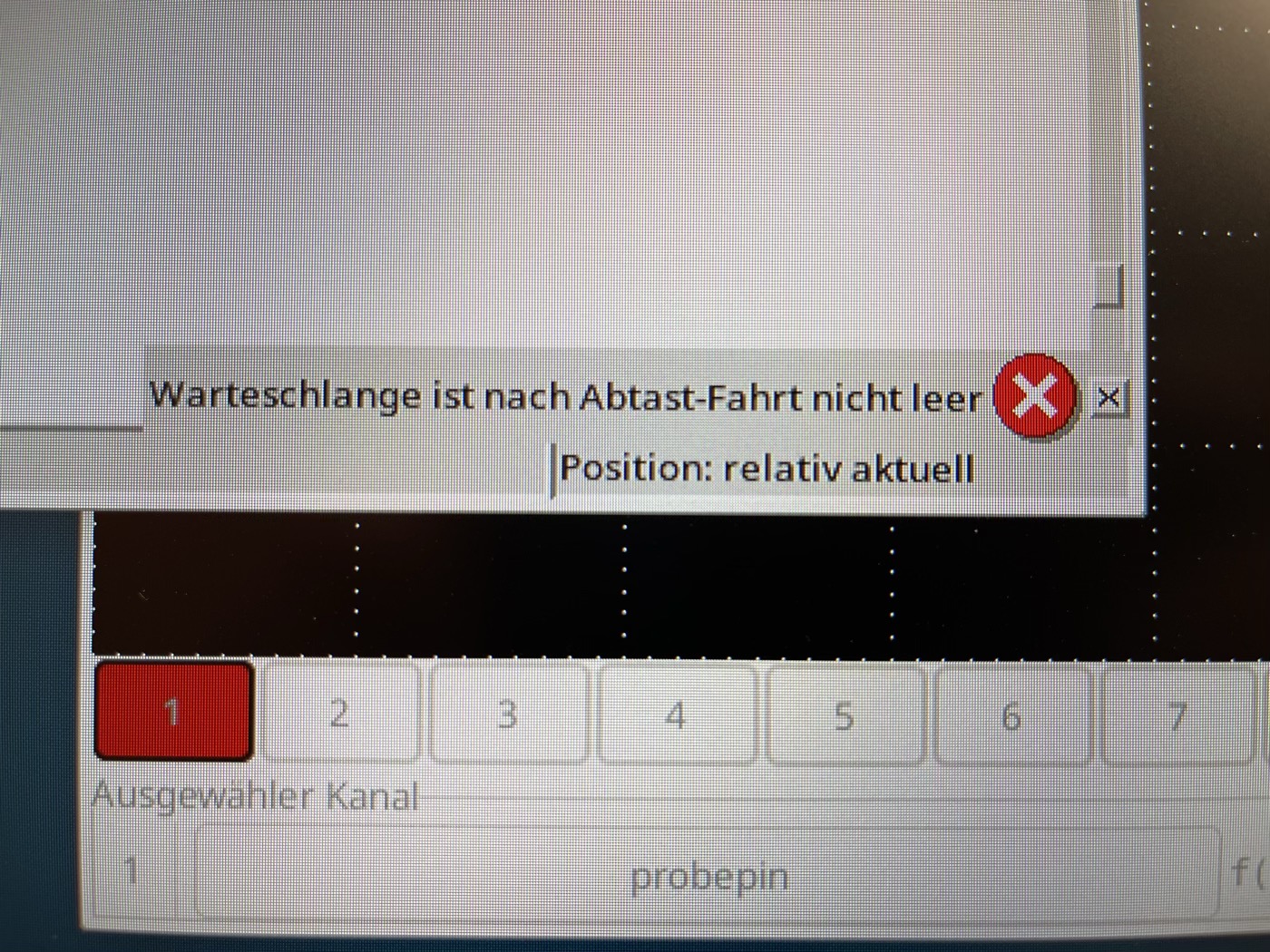

- AkkiSan
- Posts: 19
16 Aug 2025 23:35 - 16 Aug 2025 23:36 #333528
by AkkiSan
Replied by AkkiSan on topic How to fix "Queue is not empty after probing"
I now have the same issues.
Happening after ~250 probe commands or so. All at different positions; of course also encapsulated in oword-loops.
Initially, I only had severe problems with bouncing and had to fix it with a flipflop (which works fine):
www.forum.linuxcnc.org/38-general-linuxc...move-deadlock#332412
And now this.
Is this even related to the probe command or is it also possible that the origins are something completely different?
This all was never an issue with (really
old versions; I probed millions of positions.
Meh,
AS
And now this.
Meh,
AS
Last edit: 16 Aug 2025 23:36 by AkkiSan.
