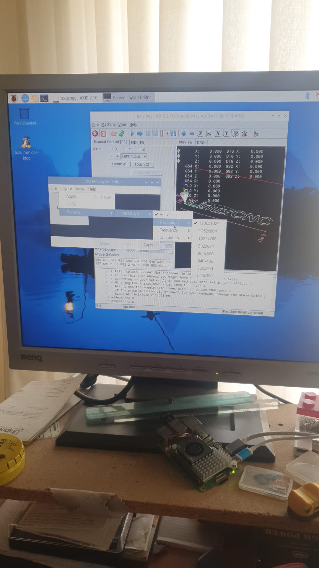

I have downloaded LinuxCNC 2.9.2 for pi4 and pi5. Pi4 works perfect so far,but on the pi 5 i cannot change display resolution it is stuck on 1920x1080 i have tried to edit profile , xrandr but get gamma error if i change config.txt it only works before loading xfce4 then 1920x1080. I also downloaded image again just to be sure. I have alse tried to google a solution , no luck !

Replied by elovalvo on topic LinuxCNC 2.9.2 Raspberry pi 5 cannot hange resolution
The image you find in this link has no problems with the video driver
forum.linuxcnc.org/9-installing-linuxcnc...pi-5?start=60#287616

05 Feb 2024 10:11 #292499
by elovalvo
he file must be decompressed with 7zip (www.7-zip.org/) and the image can be written to SD with Balena Etcher (etcher.balena.io/).
As you can see from the photo, LinuCNC works and you can select the screen resolution.

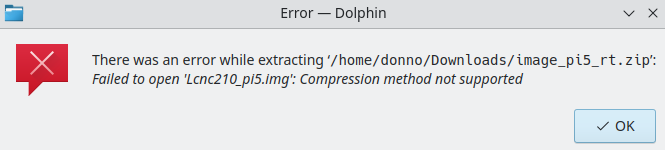

I checked.When i download the image and extract it i get error, third attempt.
The pi5 image from the site is the one with video driver problems.

05 Feb 2024 12:23 - 05 Feb 2024 12:24 #292502
by Donno
Replied by Donno on topic LinuxCNC 2.9.2 Raspberry pi 5 cannot hange resolution
Thank you so much it worked ! I used :
7zz x image_pi5_rt.zip
command in Ubuntu terminal to extract
