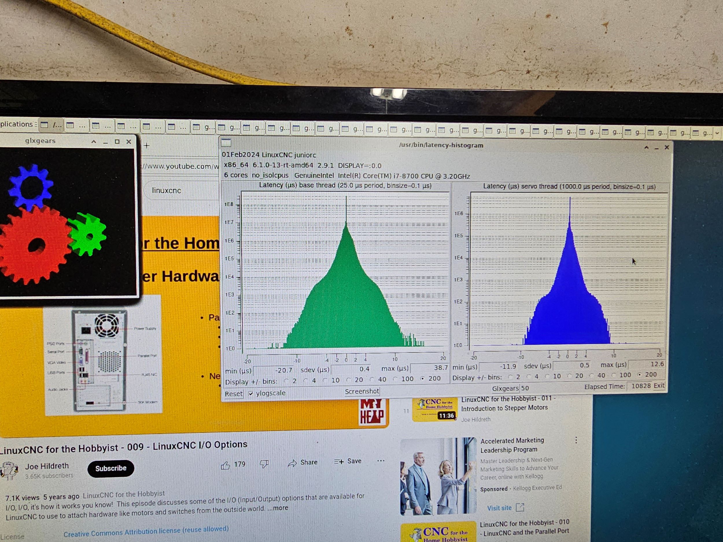

It's been a while but, I believe I have a decent computer now. It has a Asus Prime H310-Plus mother board, I'm running Corsair vengeance lpx 32GB 2666MHz ram, Samsung sm961 512GB SSD, and an AMD Radeon 8490 1GB video card. I have also made a handful of changes to the bios. I have attached a Latency Histogram. If the group thinks its a solid Linuxcnc. I would like to know which is the best direction to go far as a Mesa set-up. I know the plug-n-go kits have been out of stock for while now. This is for a DIY CNC Router that I've been gathering parts for. I have both steppers and servos, they are old Parker Gemini drivers. Is the servos overkill? If not whats the best board for the steppers and servos? I know that I'll need to purchase two different set-ups for each the servos and steppers. If I can get the steppers to work. I like to give the servos a try.

Latency looks good.

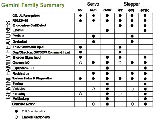

I think you're confusing the drive command signal format with the motor type.
The boards vary by command signal output and other capabilities, not by type of motor they can control.
The Gemini's can handle step & direction input as well as analog +/-10v. If you need four motors for your router (XYYZ) plus a spindle, the 7i96S can handle that all by itself.
