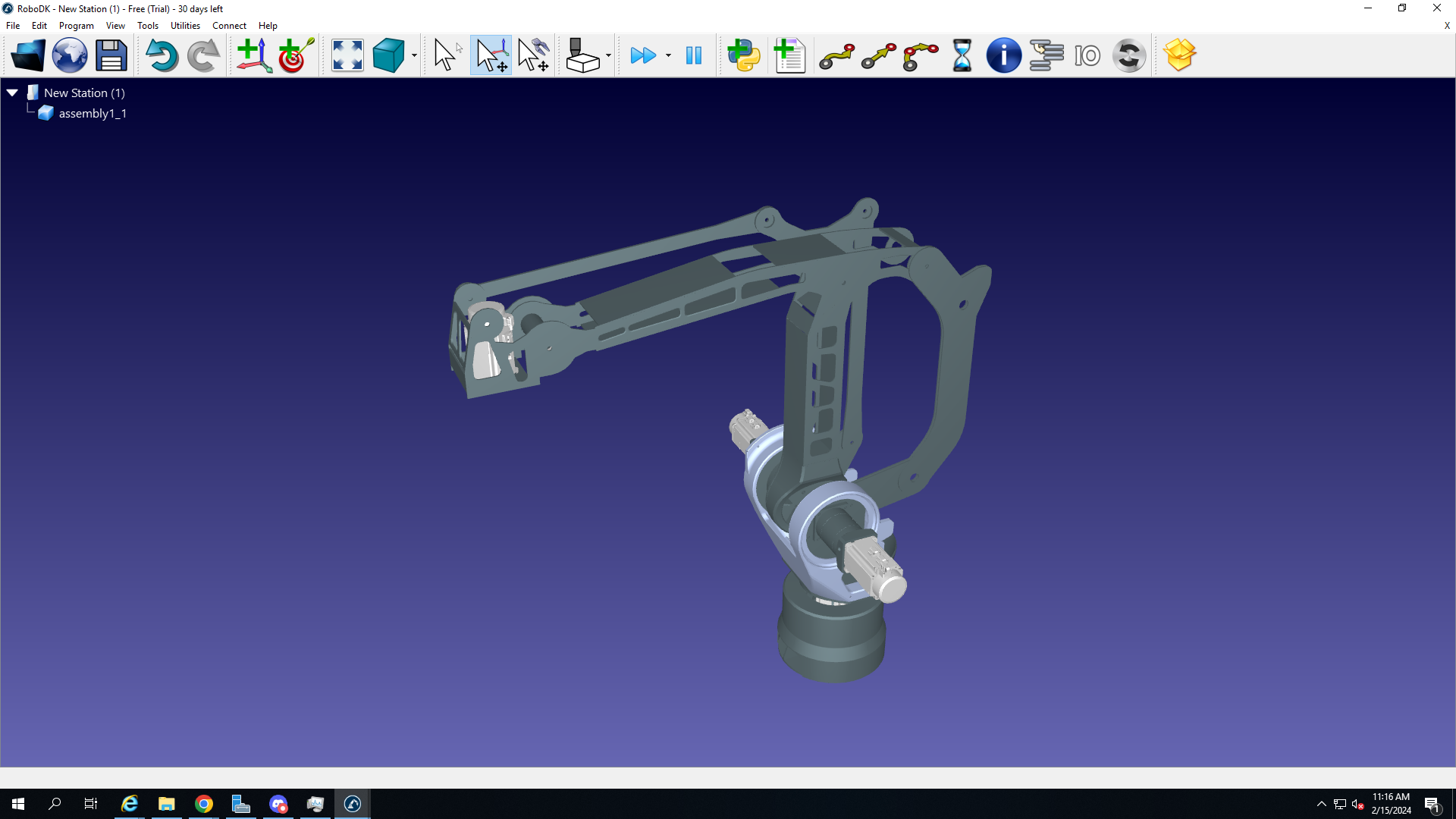

anyone know on how to start running a 4axis palletizer robot in linux cnc w/ ethercat?
this is how the robot looks now, anyone that can plz help since im a complete beginner on linuxcnc right now..

I don't think there is a ready made kinematic component for a palletizer in LinuxCNC. So you would need to create that first.
Maybe this document can help you with it (together with the assistance of an online translator like deepl) as the mechanics of the robot seem to be quite similar:
dspace.cvut.cz/bitstream/handle/10467/11...uence=-1&isAllowed=y
As for how to implement it in LinuxCNC, I would suggest to install debian bookworm and install linuxcnc using the synaptic package manager. Then you can have a look at the simulation configurations that come with it and ask more specific questions once you have the system installed.
Development of the kinematic module can be done as a pure simulation, preferably using a vismach simulation file (like the one found in 'configs/sim/axis/vismach/' folder of a linuxcnc installation)
Hardware implementation in LinuxCNC using EtherCAT will be a separate part of your project that will depend on the kind of motor drives you are using.
