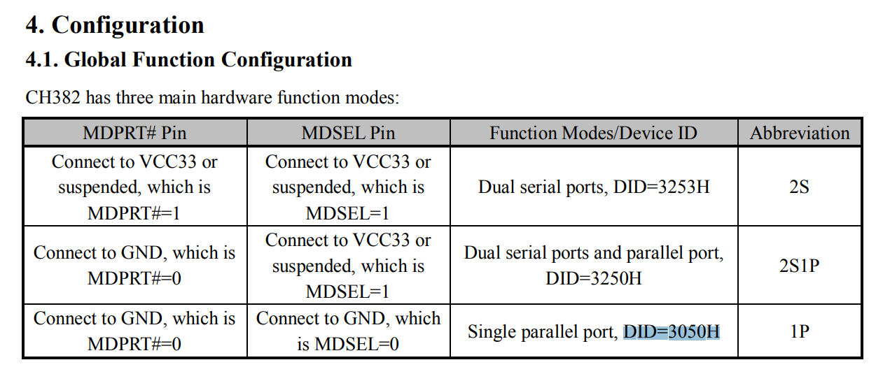

- Mecanix
- Posts: 447
- Thank you received: 229
02 Mar 2024 19:12 - 02 Mar 2024 19:35 #294931
by Mecanix
Replied by Mecanix on topic CH382L, M.2 to PCIe adapter on SBC not recognised by Linuxcnc
Last edit: 02 Mar 2024 19:35 by Mecanix.
- Mecanix
- Posts: 447
02 Mar 2024 19:21 #294933
by Mecanix
Let's have a look at your $lspci and $lsmod
#define VENDOR_ID_WCH_PCIE 0x1C00
#define SUB_VENDOR_ID_WCH_PCIE 0x1C00
#define DEVICE_ID_WCH_CH382_2S 0x3253
#define SUB_DEVICE_ID_WCH_CH382_2S 0x3253
#define DEVICE_ID_WCH_CH382_2S1P 0x3250
#define SUB_DEVICE_ID_WCH_CH382_2S1P 0x3250Please Log in or Create an account to join the conversation.

See edit two up (addy 0x3050)
