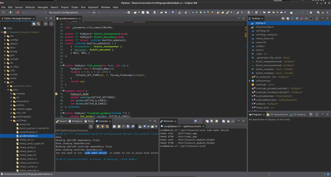

03 Mar 2024 21:45 #295092
by Mecanix
1. Eclipse CDT (projects.eclipse.org/projects/tools.cdt)
2. Yes, quite a few in fact. One out of many (linuxcnc.org/docs/html/config/python-interface.html)
3. Eclipse CDT (sudo apt install gdbserver) & PyDev server (marketplace.eclipse.org/content/pydev-python-ide-eclipse)
Hope this helps.
Eclipse >> Import >> C/C++ >> Existing Code as Makefile Project >> Select "Linux GCC"
Replied by Mecanix on topic How to read the source of the LinuxCNC?
Here is my specific question:
1. Which IDE do you use? Cause I was used to be a windows developer, I am just familiar with Visual Studio.
2. Is there any docs for developer guide? Although here is some docs in package, but they seems like told us how to use linuxCNC.
3. How to debug the source code? I want to debug the code, make the break point to know how the data circle around the system.
Hope this helps.
$ git clone https://github.com/LinuxCNC/linuxcnc.git
$ cd linuxcnc
$ ./debian/configure
$ sudo apt-get build-dep .
$ dpkg-checkbuilddeps (<--should retun null if all good)
$ cd src
$ ./autogen.sh
$ ./configure --with-realtime=uspace --disable-build-documentation-translation
(do not make. Import in eclipse at this stage and dev all you need)Eclipse >> Import >> C/C++ >> Existing Code as Makefile Project >> Select "Linux GCC"
