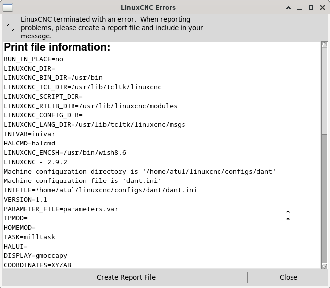

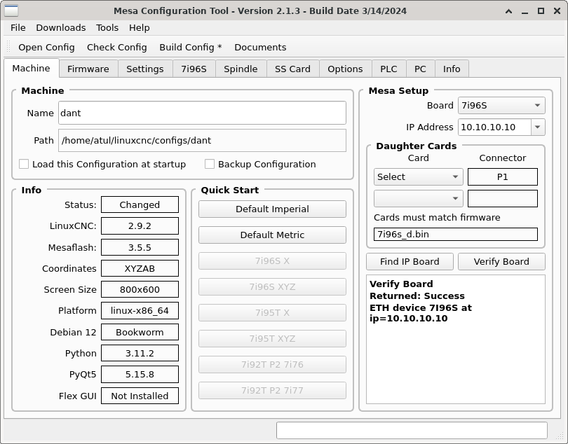

I Run Linuxcnc with Masact Generated INI File this Linuxcnc Error. please Help Any one?
Error report created by /usr/lib/tcltk/linuxcnc/show_errors.tcl:
Print file information:
RUN_IN_PLACE=no
LINUXCNC_DIR=
LINUXCNC_BIN_DIR=/usr/bin
LINUXCNC_SCRIPT_DIR=
LINUXCNC_RTLIB_DIR=/usr/lib/linuxcnc/modules
LINUXCNC_CONFIG_DIR=
LINUXCNC_LANG_DIR=/usr/lib/tcltk/linuxcnc/msgs
INIVAR=inivar
HALCMD=halcmd
LINUXCNC_EMCSH=/usr/bin/wish8.6
LINUXCNC - 2.9.2
Machine configuration directory is '/home/atul/linuxcnc/configs/dant'
Machine configuration file is 'dant.ini'
INIFILE=/home/atul/linuxcnc/configs/dant/dant.ini
VERSION=1.1
PARAMETER_FILE=parameters.var
TPMOD=
HOMEMOD=
TASK=milltask
HALUI=
DISPLAY=gmoccapy
COORDINATES=XYZAB
KINEMATICS=trivkins coordinates=XYZAB
Starting LinuxCNC...
Starting LinuxCNC IO program: iov2
Found file(REL): ./main.hal
iov2: exiting
hm2_eth: ERROR: Could not retrieve hardware address (MAC) of 10.10.10.10: Resource temporarily unavailable

iopl() failed: Operation not permitted
cannot gain I/O privileges - forgot 'sudo make setuid' or using secure boot? -parallel port access is not allowed
Note: Using POSIX realtime
hm2_eth: rtapi_app_main: Resource temporarily unavailable (-11)
./main.hal:13: waitpid failed /usr/bin/rtapi_app hm2_eth
./main.hal:13: /usr/bin/rtapi_app exited without becoming ready
./main.hal:13: insmod for hm2_eth failed, returned -1

Look you are going to need to post the hal & ini files.
Check the address of your Mesa card, the documentation of your card contains this info, this documentation can be downloaded form the Mesa sight.
Make sure the mesa card and computer do not have the same address.
Check you cables.
Only have a cable between the mesa card and the pc no hub\switch\router or any other exotic hardware.
An USB to Ethernet device is not recommended to connect the computer & mesa card.
But the hal & ini files are important.
Check you cables.

Using MesaCT to create a config for parallel port will probably not work.
The error says no access to parallel port.

And also it looks like you have not set the networking to use the Mesa card.
forum.linuxcnc.org/27-driver-boards/3559...ethernet-mesa-boards

Thanks all sported team I try it’s but sub mask not 10.10.10.1 I set it. 255.255.255.1
- Posts: 21885
- Thank you received: 7461
19 Mar 2024 09:46 #296297
Replied by tommylight on topic Masact File genrated file run in Linuxcnc not Work Linuxcnc Error
No, subnet mask must be 255.0.0.0 or 8 for 10..n.n.n, but it also works with 255.255.255.0 (not 1 at the end).
