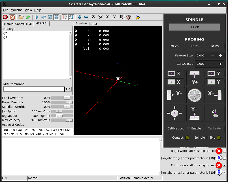

on axis g2 and g3 not responding. go g1 working good.

G2 and G3 will do nothing on it's own as you have them in MDI, they need other values
linuxcnc.org/docs/html/gcode/g-code.html#gcode:g2-g3

What did i miss ?
On the screenshot, the MDI list has ONLY G2 and G3 without the required R i j k values, as noted on the bottom right, so that will do nothing as such.
