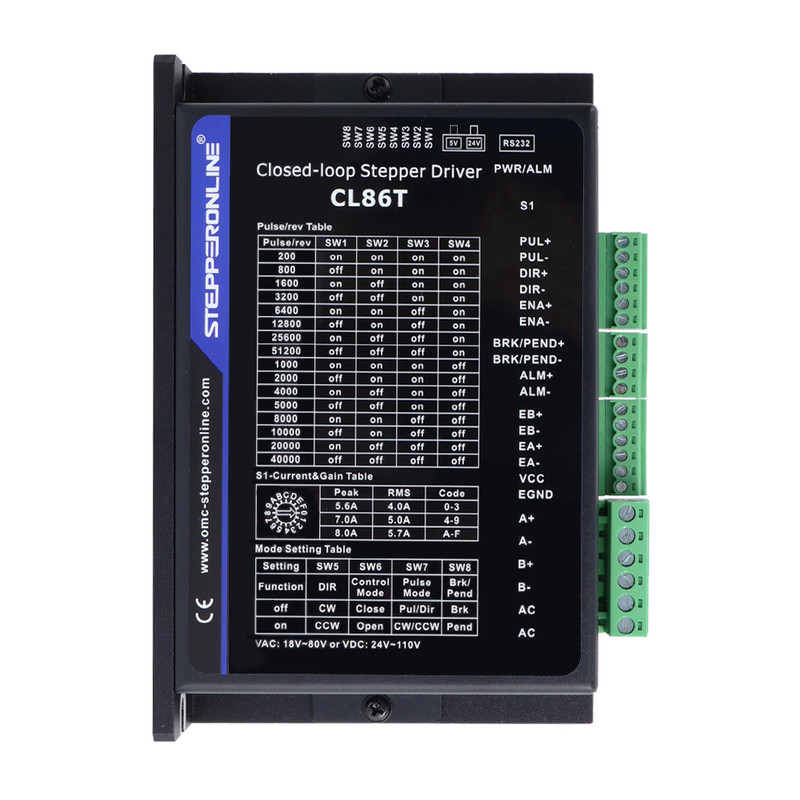

Good evening, I wanted to ask for your help, I want to make a CNC houter with stepper motor feedback using a rotary encoder, I'm using a parallel port, in my region it's not easy to find a table board. But I don't know where to start, what do I have to do so that if the machine loses a step, the encoder immediately identifies it and the machine stops and gives an error? I started about 4 months ago on Linuxcnc, I'm still learning, I ask you to be patient with me, thank you in advance

Wouldn't bother with Lcnc, PID, endless hal configs and all that glorious hunting. Just get closed-loop stepper drivers, they're inexpensive like 20~30bucks each and does it all and beyond. Just ensure the driver you pick has a rs232 port and a firmware you can access for config - you'll need that to set ppr and scaling...

03 Apr 2024 21:52 #297542
Replied by tommylight on topic how to provide position feedback for stepper motors with a rotary encoder
Yeah, that will not be 20-30 bucks for sure...
- Posts: 18063
- Thank you received: 5308
03 Apr 2024 22:01 #297544
Replied by PCW on topic how to provide position feedback for stepper motors with a rotary encoder
Not too much more though
(StepperOnline lists the CL86 at $43.94, and a matching motor at $42.04 so $85 total)

Yeah you're prolly right, 12~15 bucks huge max...Yeah, that will not be 20-30 bucks for sure...
- Posts: 21885
- Thank you received: 7461
03 Apr 2024 22:20 #297546
How the hell do i get those here??? Last drives i got were DM556 i think, 54 Euro a piece in Germany from amazon.de !
Still cheap!Not too much more though
The only drives costing 12$ are those wrongly named TB6600, the original TB6600 are 18 and up, and in this cases the wrongly named ones are better and cheaper, albeit about 1A less current.
