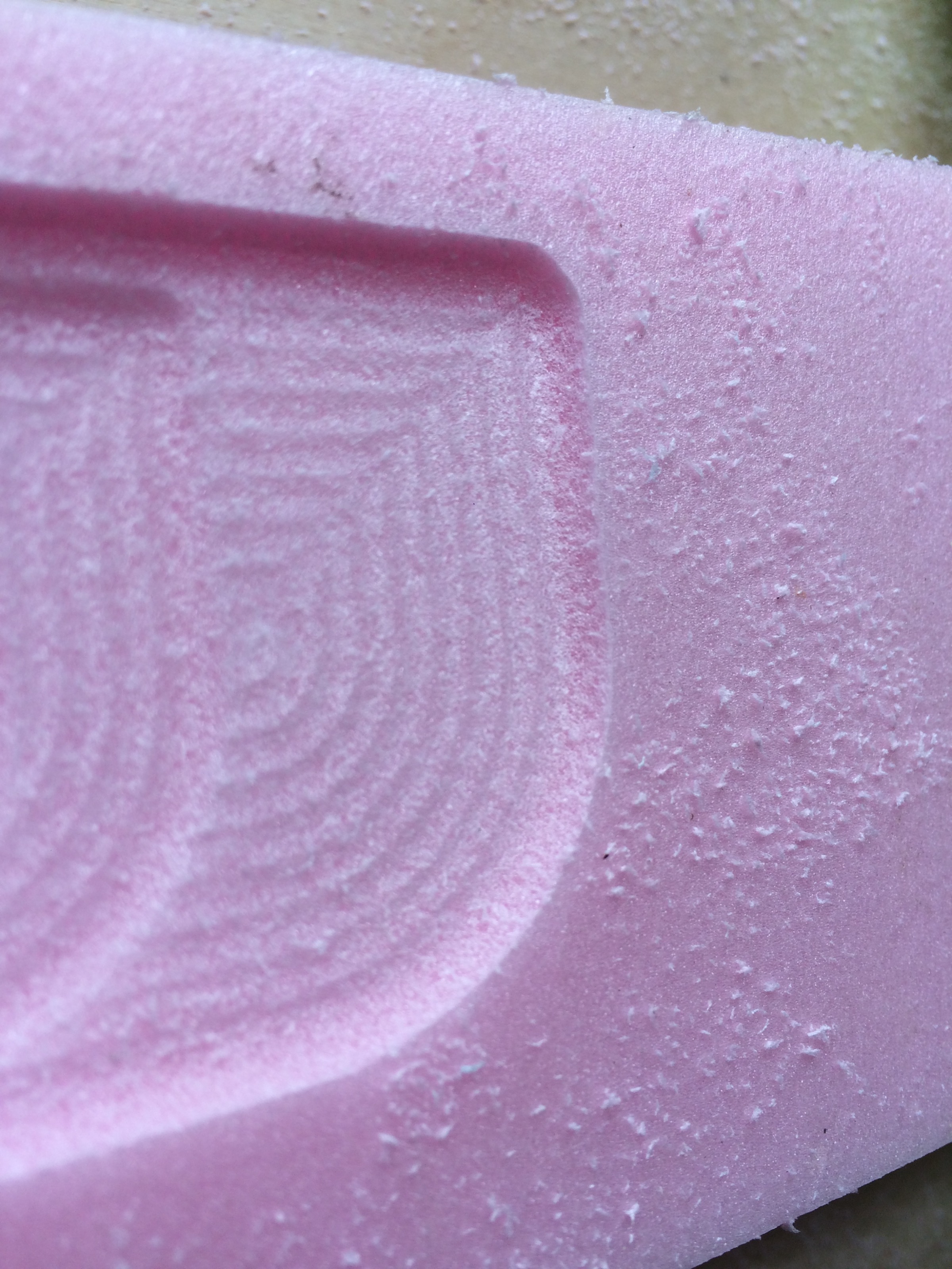

Afternoon All.
I recently built a cnc table. I made a plasma table years ago and had no issues, router adds a few more dimensions, now I am confused.
My issue is the cut path is an oval rather than squared corners. I use Kirimoto as my slicer, it shows square corners and the animation gives square corners. Move the file to my cutter and it also shows squared corners in the preview. When I cut, the corners become rounded, exception of one corner where the tool always moves to the next x y z start position.
I am including two photos, one is a cut track as shown on linux the second photo is of a different file and shows the actual rounded corner, opposite end of the cut is completely rounded.
Any thoughts?

And this is a bit confusing, racetracks are created by the cutter, so not a software issue, but rounded corners can be software issues, namely G64 Pnn where nn is the amount of allowed off track motion, so G64 P0.1 would follow the line with a tolerance of 0.1mm (or 0.1 inch if the machine uses inches).
You should add that to the ini file, startup G code, section and set the CAM to also output that before every part cut.
What version of LinuxCNC are you using?

Round tools can not make square corners, so if the corner is the exact end mill radius, all is good.

Went through the g code could not find a g64.
I am running 2.7.15

For now, in MDI just type that before running a job, and if you stop the job do this before continuing.

I now get all four square corners as shown in the cutfile
much appreciated.
