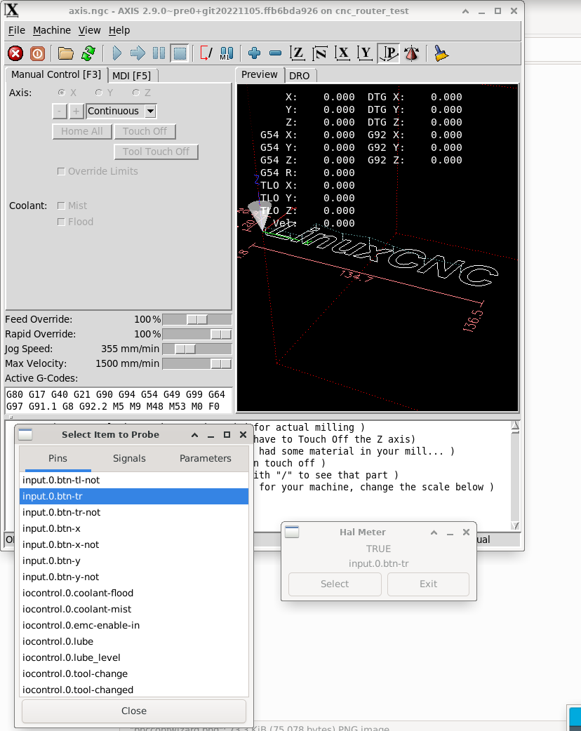

I've been having some issues in getting a wired Xbox360 controller working with LinuxCNC and could use some words of wisdom.

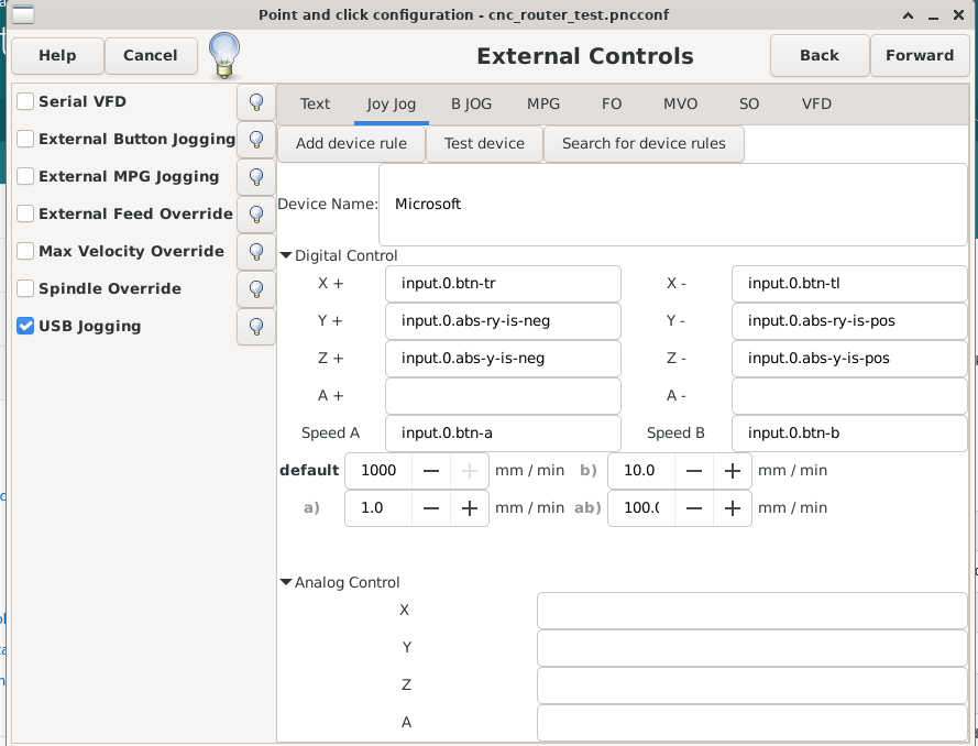

I've set up the controller in the Pncconf wizard:
I've ran the configuration in LinuxCNC but pressing the relevant controllers yields no result. However the meter does show the expected signals:
Any suggestions on what I am missing?
25 May 2024 03:12 #301370 by cmorley
is the machine homed?
  • RyanB
  • RyanB's Avatar Topic Author
  • Offline
  • Junior Member
  • Junior Member
25 May 2024 03:58 #301372 by RyanB
I haven't added limit switches yet, that's further down the line.
25 May 2024 05:32 #301374 by cmorley
Pncconf probably didn't get updated to set up unhomed joint jogging for the joystick.
So it must be homed before jogging works.
You don't need limit switches to home.
  • RyanB
  • Offline
  • Junior Member
  • Junior Member
25 May 2024 19:06 #301436 by RyanB
Is there a way to disable that requirement?
26 May 2024 03:06 #301457 by cmorley
Sure. Can you post your config files.
You could also home an axis/the machine and try the joystick to see if that is actually the problem.
