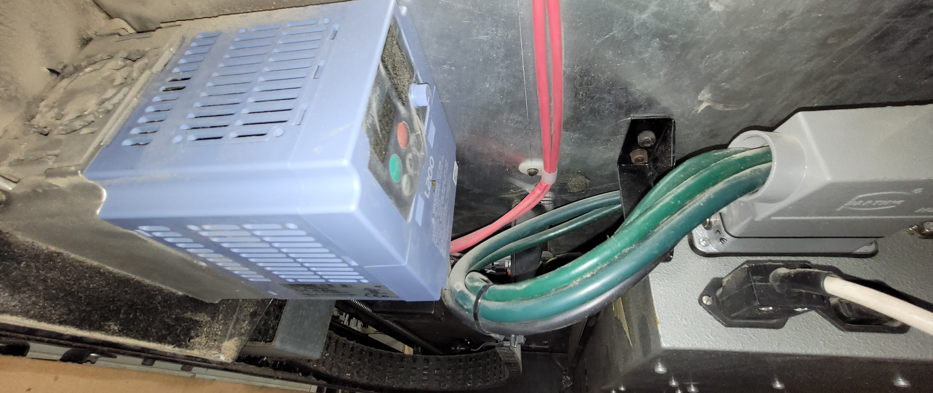

Spindle controller: Hitachi L200

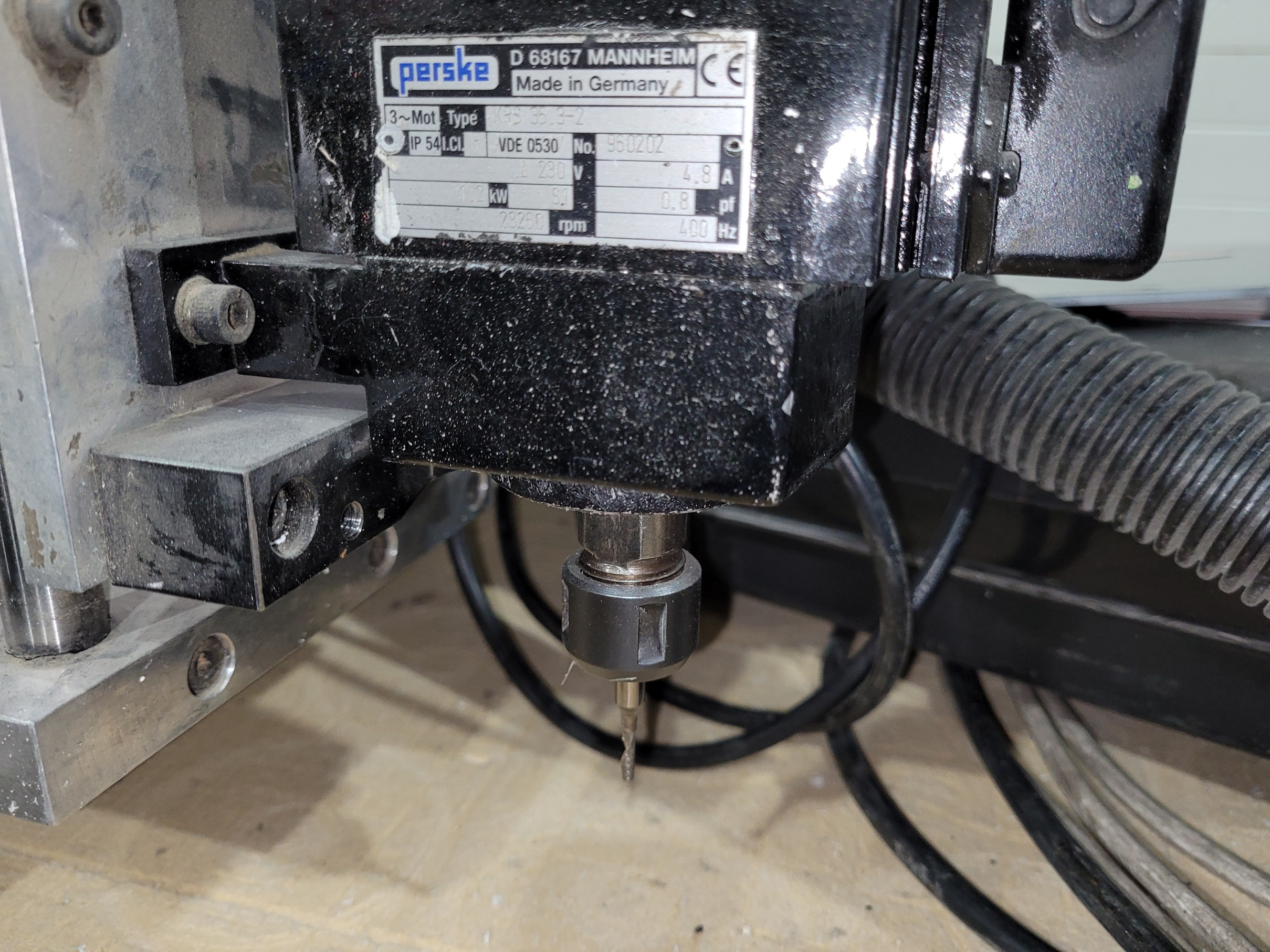

Spindle: Perske 1.2kW / 23k rpm

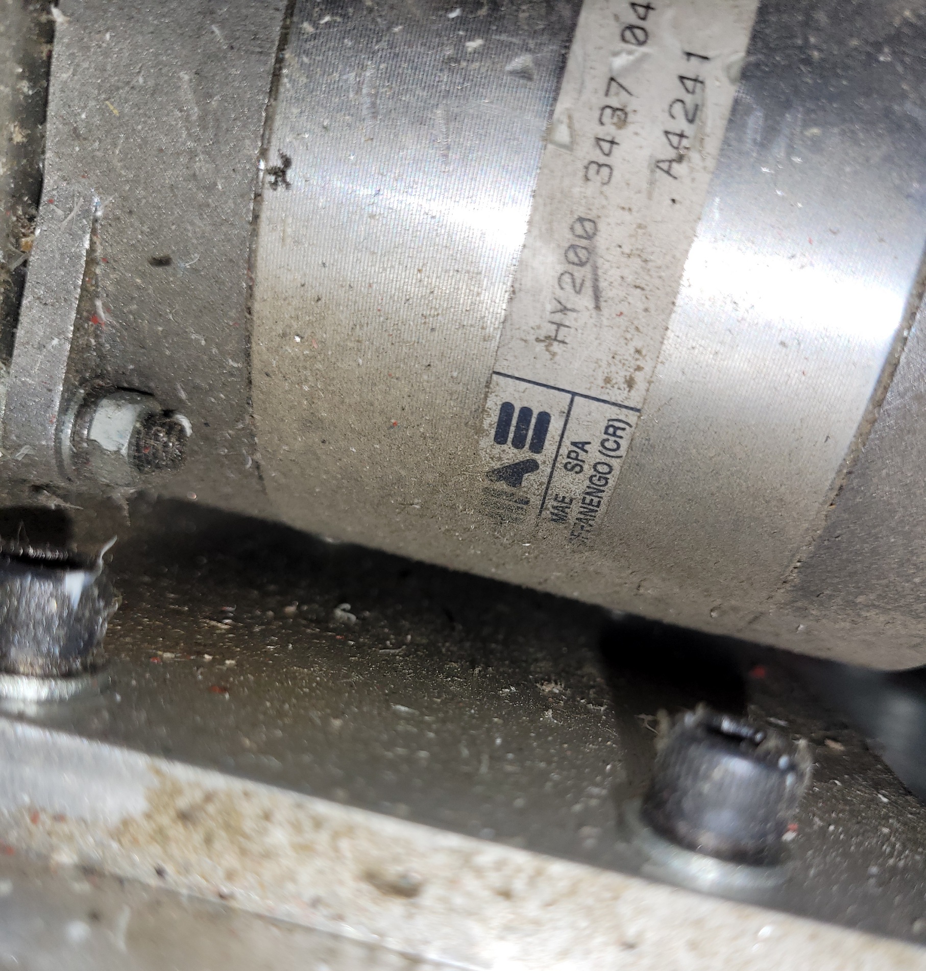

Steppers? HY200

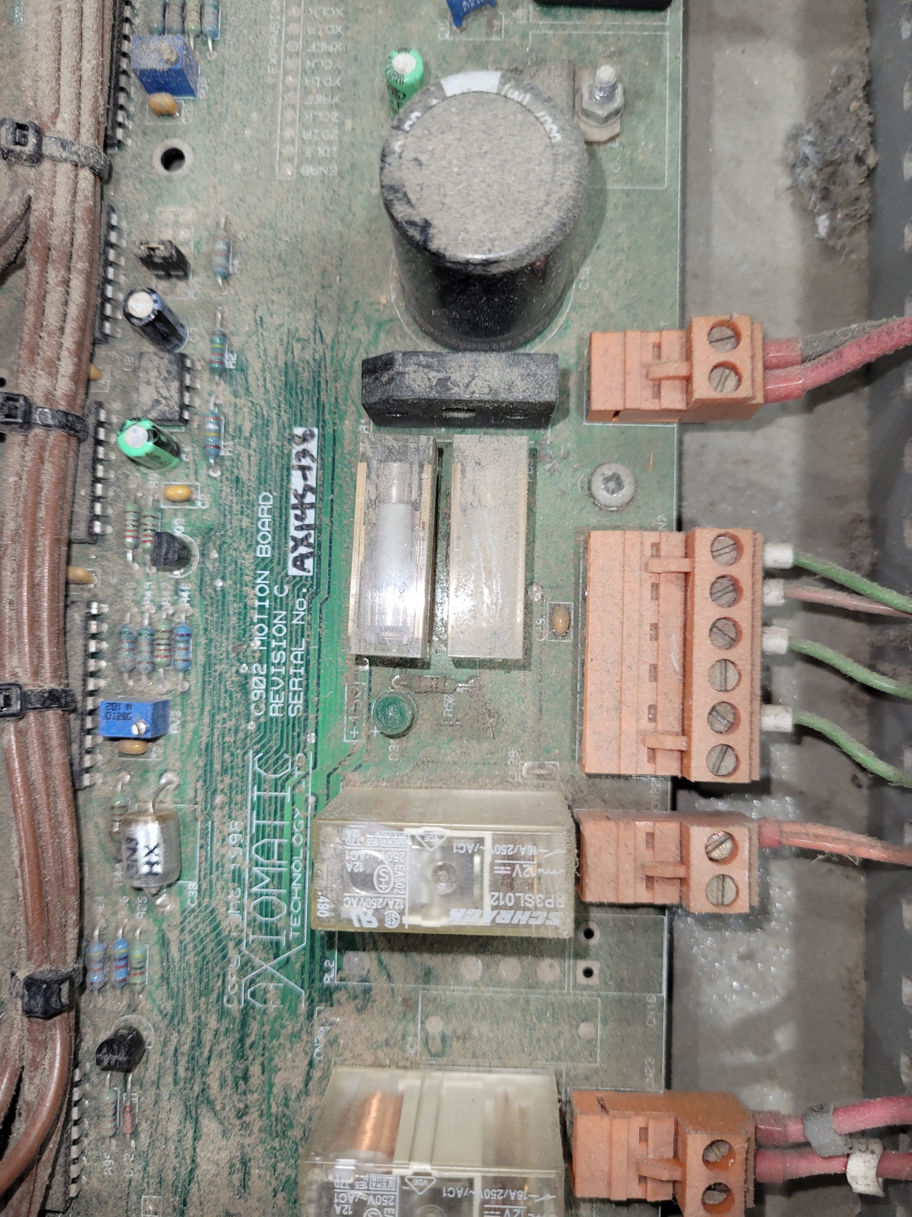

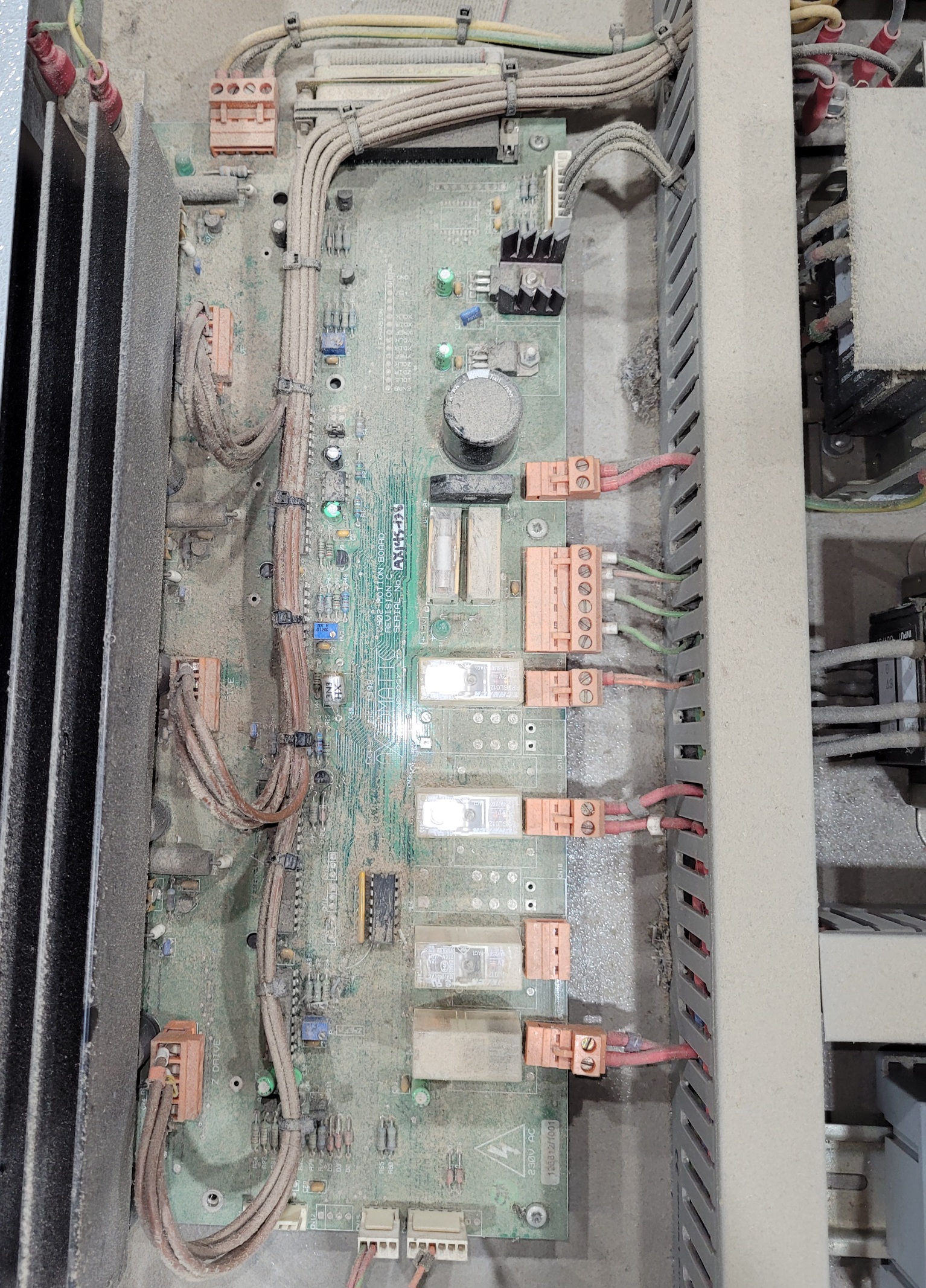

Motion board: Axiomatic C902

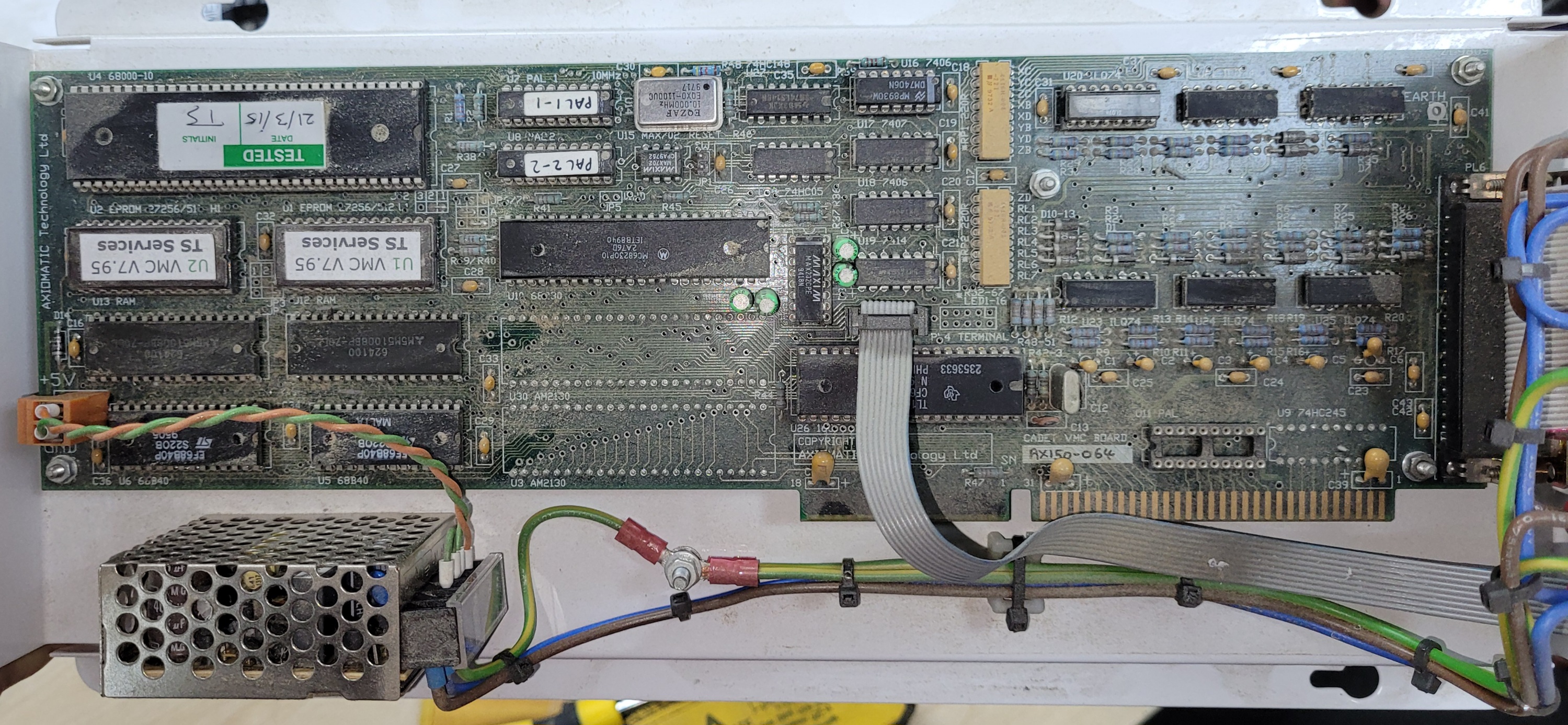

Controller board Axiomatic Cadet VMC Board (looks like an ISA board; PC connected to serial off the board; the parallel connected to motion board)
We were wondering if we could get away with sending command to the controller board from LinuxCNC or we should consider replacing controller & motion boards. Any advice and input welcome.

Cheapest way:
-an older PC with parallel port
-a BOB with spindle control
-3 of cheap TB6600 drives
total under 100$
Medium way
-a decent PC
-Mesa 7i96S
-3 of whatever drives they can afford, i would still use the TB6600
total under 300$
Best way
-a decent PC
-Mesa 7i96S
-LAM Technologies drives
-Bigger power supply
total from 500$ and up
The old drives can probably be reused, but might not be worth the time.
The old control most probably will not work with LinuxCNC or any modern control, either way serial is really, really slow.
Check the flat cable connector that goes to the drive board, how many pins does it have? I tried to count from the picture but ended up with over 30, so probably my eyes are fuzzy...

Regarding drivers, I think the steppers might be able to take ~80V but I can't find the datasheet (will give it another go some time) but since it's not going to run in an industrial setting, the highest possible speed is not really required, so TB6600 might be enough
